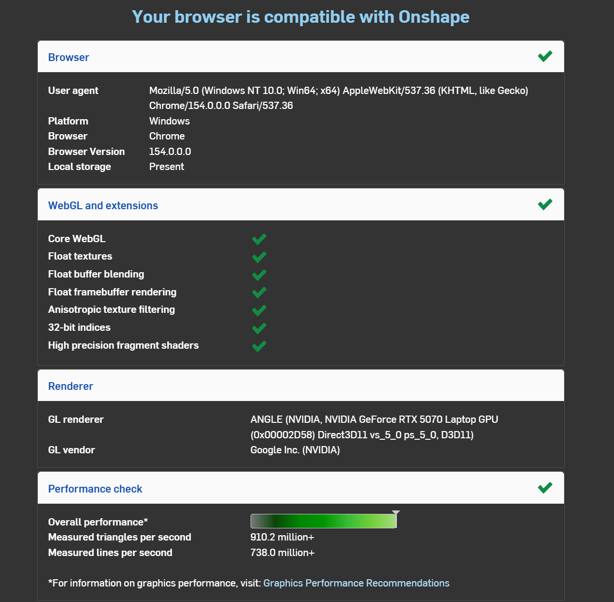

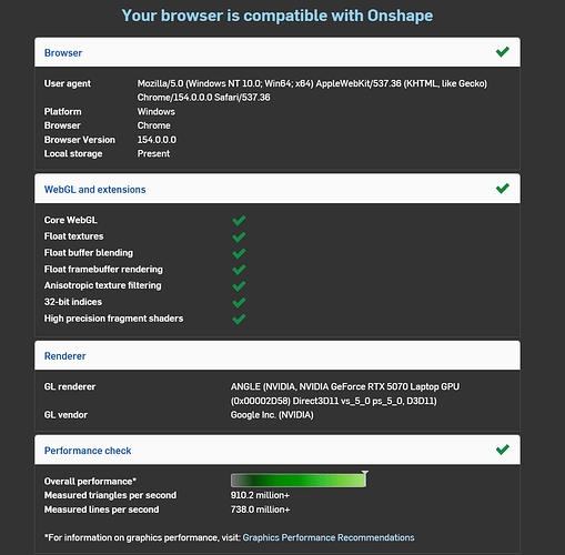

You can try checking if your laptop is compatible with Onshape here. You should get a message determining if you are compatible, like this.
This should help determine if the problem is your laptop or the website itself.
Additionally, if your laptop has 2 separate GPUs, make sure the browser you are running Onshape on is assigned the discrete GPU. This was the problem I had last time, and changing the GPU running my browser from the integrated to the discrete one provided a major boost in performance. You can change this on the windows graphics setting. This Onshape article goes much more in-depth into this.
I hope one of these suggestions help, and good luck!
