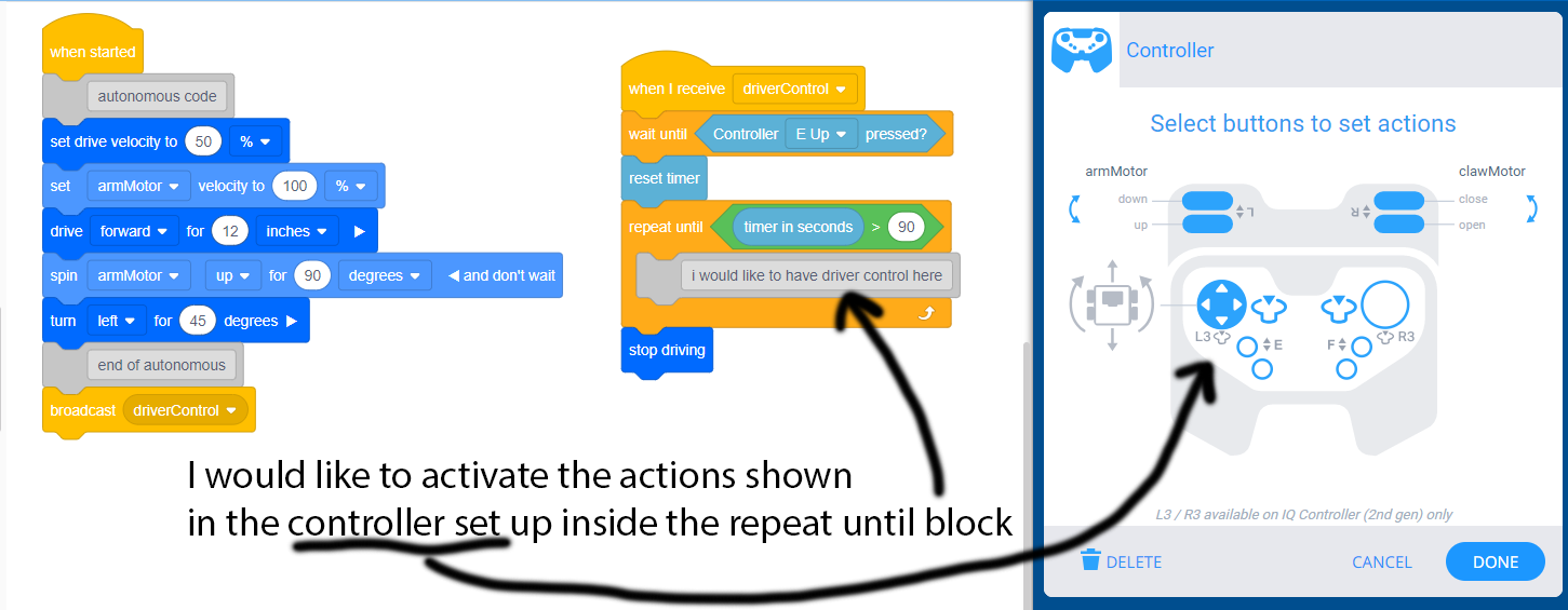

I am teaching a middle school robotics class using VEX IQ. I am trying to have a classroom competition where the students program an autonomous and then follow with a driver control period. I am trying to make this as simple as possible using VEXcode blocks and use 2 motor drivetrain. What we are doing currently is creating 2 seperate programs, and autonomous and a driver control but I would like to create 1 program similar to the competition template for V5 but there are no blocks for When Autonomous and When Driver Control.
How do I have program a driver control period using the code I have in the picture?

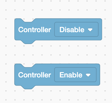

This block may do what you want:
Screen Shot 2022-10-18 at 9.58.49 AM
Here’s something that might work. It’s EXP code but I assume the same thing should work in IQ:
Screen Shot 2022-10-18 at 12.43.24 PM
Student autonomous code would go under “define Autonomous.” I don’t see a way to limit the time for autonomous mode, but it looks like you weren’t trying to do that anyway.
(Edited): Controller is enabled after A button is pressed. (I originally posted a more complicated and less effective version, not realizing that “Controller Disable” only disables the menu-configured controller behavior, and doesn’t stop you from waiting for a button press.)
Thank you holbrook, this worked for what I wanted to do. Thanks to everyone else for responding.
