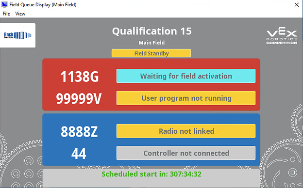

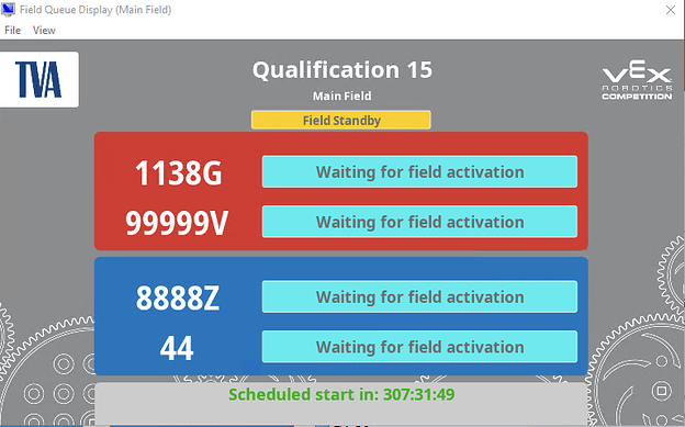

The old field control system uses discrete digital logic to signal the states of the field. A single pin on the RJ45 connector would toggle from high to low to signal that the field was changing from “Disabled” to “Enabled”. There was no real data passed between the robots and the field. The new Smart Field controllers use special software running on a V5 brain. The field brain connects to the smart port on the V5 controllers to pass not only the same field state information as the old system but also additional data like the match clock time. The V5 controller can also pass information to the field controller about that state of the robot (radio link info, battery levels, is the user app running, …). This information can be used to quickly troubleshoot issues with robots on the field. The field brain also connects to the Tournament Manager software so all this information can now be displayed on the field monitor to allow the referees to know if all systems are good to go before the match starts.

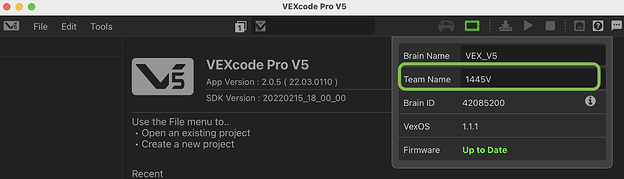

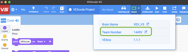

First make sure your robot is ready to connect to the Smart Field controller. Your controller and robot brain will need to be running the latest VEXos firmware (1.1.1). Also you will need to set your team number on your robot brain. Setting your team number in the brain allows Tournament Manager to display your robots status next to your team number on the field monitors. You will have the ability to set your team number during inspection but you can also set it yourself using
VEXcode Pro V5:
Or VEXcode V5:

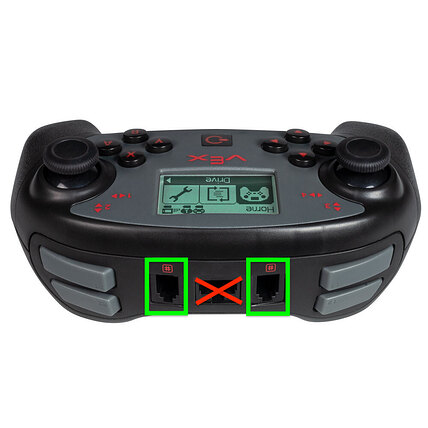

For VRC matches, each driver’s station will have two smart cables. It does not matter which cable you use. Blue team cables will be at the blue team’s driver station and the red team’s cables will be at the red team’s driver station. You can connect one of the smart cables to either of the two smart ports on your V5 controller.
NOTE: MAKE SURE NOT TO PLUG THE CABLE INTO THE LEGACY FIELD CONTROLLER PORT. THIS COULD DAMAGE YOUR CONTROLLER. You should always connect the field control cable to the V5 controller that has the radio connection to the robot. So if you are using a dual controller setup make sure you plug the field’s smart cable into the controller that is paired with the robot. Once you connect the cable to your controller you will see the field symbol show up on the status bar of the controller and you are officially connected to the field.

lol why :skull: ​​​​​​​​​​​​​​​​​
because that helps us correlate the team numbers in Tournament manager with the data it’s getting from the field controller. Field techs then know which team may have a problem.

Looks interesting. I notice the status codes appear to just be hexadecimal codes, will those values be documented? Or ideally, if they’re non-nominal, expressed in a more human-readable form in Tournament Manager?
Good question. James is correct. But I will update the post with that info.
The team details screen is mainly for staff use at worlds, the field control hardware may not even be easily visible. TM will display issues in human readable form.
