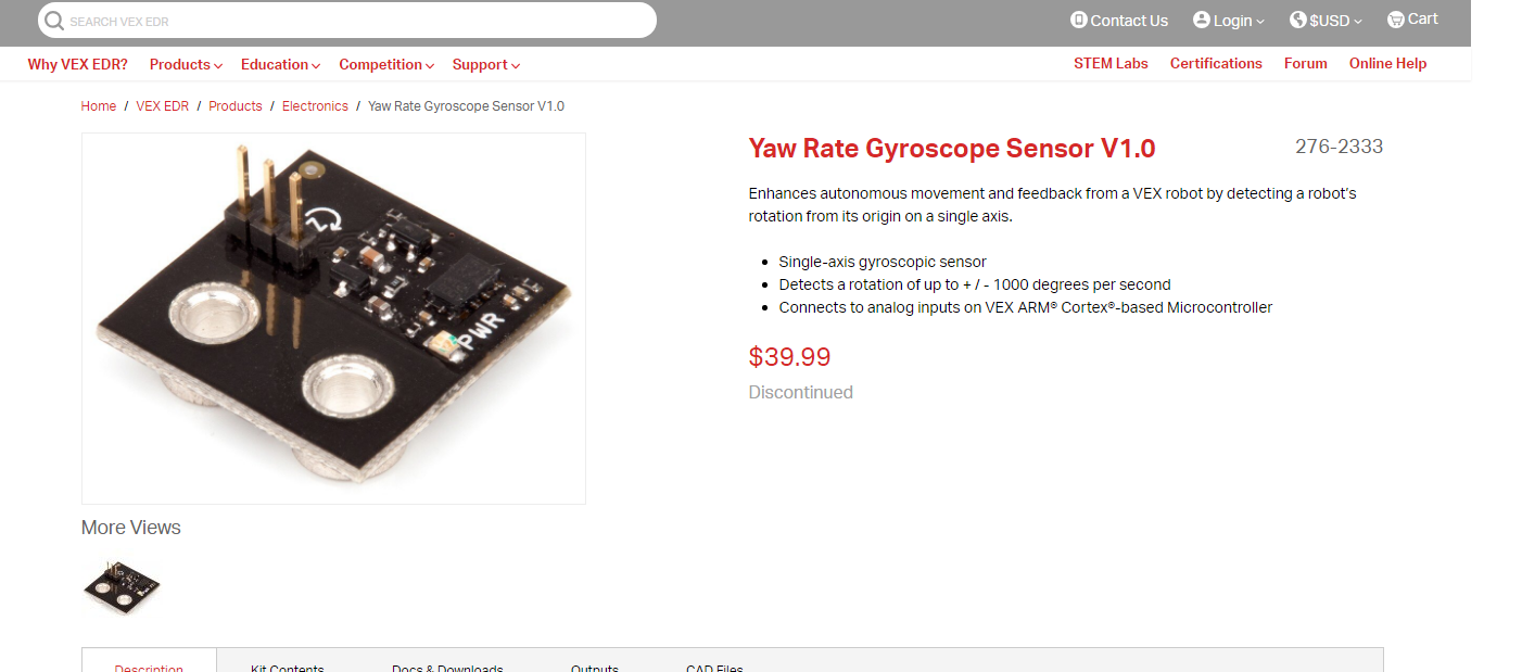

Was checking the Vex Website and noticed that the Current Gyroscope has been discontinued! Does this mean that a new Gyro is coming out shortly?
I certainly hope so…

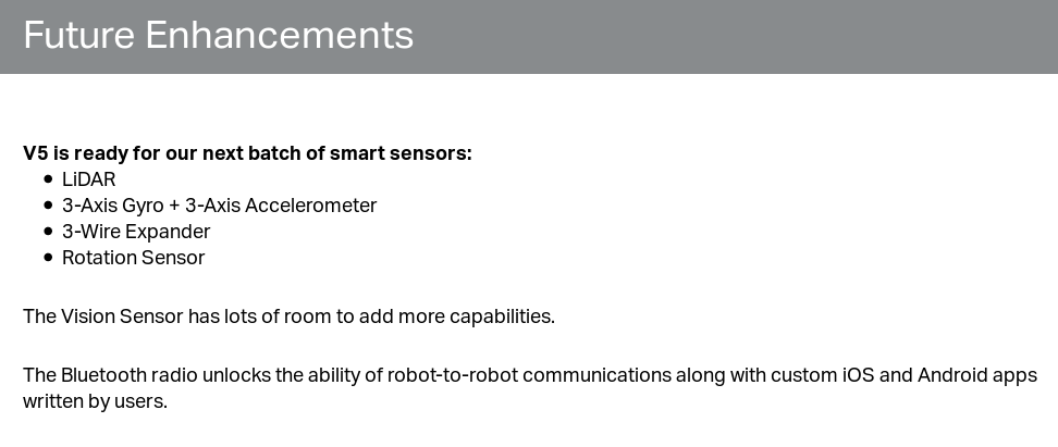

All I want is some sort of expander for the measly 8 sensor ports on the V5 (considering a couple sensors use 2 ports each). That or a new array of sensors you can actually use with the 12 extra ports on the V5. But considering they didn’t announce anything was coming at worlds, I doubt it.
With odometry, you literally have 2 ports. At least an expander is well overdue. Using sensors is a super important skill that translates directly to the real world. Limiting the use of sensors with something as silly as the amount of LEGACY ports is not a good look. I hope V5 sensors come soon.
The tming here is a bit odd, considering development seems very much active on a gyro-based drivetrain in VexCode V5 Blocks - this feature was added only three weeks ago:
My fingers are crossed for a single sensor with gyroscope, accelerometer, and compass all integrated, like this sensor on Adafruit. Hopefully that would drive down the cost and not use too many ports.
One of my worries about the shift to all smart ports is that there are only 20 of them (not counting the one connected to the radio).
As VEX decided to make each sensor or motor be the master controller for the bus, connecting multiple sensors to the same bus (i.e., port) is impossible. Because of this, a “smart port expander” would need to manage multiple RS485 buses separately and exchange data between them. This would be expensive, impractical, and would introduce very high latency (even higher than the 10ms hit we get to begin with).
The legacy Cortex had 8 digital ports, 12 analog ports (that could be used as digital ports if required), and 10 motor ports (that could be Y-cabled to connect even more motors). The V5 brain has 20 smart ports for both sensors and motors, and 8 ADI ports for simple buttons (once all the other sensors get replaced by “smart port” equivalents). No matter how you do the math, we could be looking at a significant issue of running out of ports with the new V5 system once 3-wire sensors get phased out in favor of smart port sensors.

I’m intrigued by the AbsEncSensor. An absolute encoder? That would potentially be pretty cool for lifts, arms, and the like. You wouldn’t need a limit switch to “home” the device whenever it’s turned on (that’s my understanding anyway, I’m definitely not an expert in the field of encoders). This is probably the “Rotation Sensor” referenced.
ImuSensor seems to be confirming my suspicion of an accel/gyro combination unit, which would be good to see. (Although there’s also a GyroSensor listed. Maybe it’s just a 3-axis accelerometer? The V5 page doesn’t make it clear whether the V5 3-axis gyro and 3-axis accelerometer are different sensors…)
I wonder what the difference between RangeSensor and SonarSensor is. Is a different distance sensor in the works? Infrared perhaps? Or RangeSensor might be the LiDAR, although you’d expect them to have chosen a more descriptive name.
BrainSensor looks odd. Maybe it’s for connecting two brains together? TetherSensor seems like it could be for controllers.
I’m a bit confused as to why GyroSensor and SonarSensor are in hexadecimal while all the others are in decimal. Perhaps we’ll never know. But these are also the two sensors that have close equivalents (ImuSensor and RangeSensor). These might refer to the legacy 3-wire versions, but there’s already an AdiSensor listed… jpearman pointed it out below.
Oh, and I’d be a bit surprised to see a V5 gyro so soon considering the V5 3-wire expander hasn’t even been released yet. You’d think that’d be easy, as it’s essentially a copy-paste of the Cortex M0 circuit out of the Brain and into an external sensor. (Also odd that that sensor is not listed in the V5_DeviceType enum that @Codec brought up, unless it’s the AdiSensor one.)

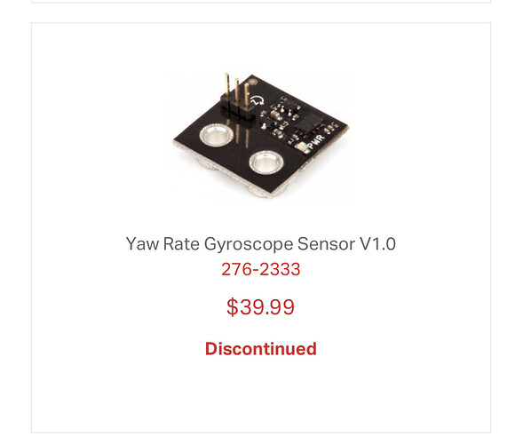

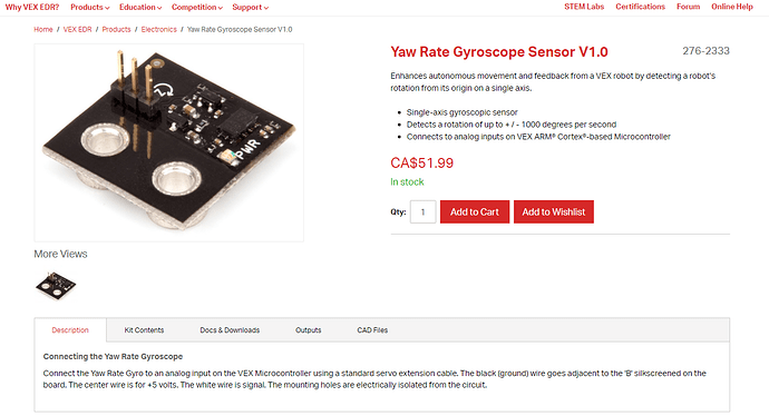

I don’t see how the Gyro is discontinued:
Perhaps it 's only for the US?
Yikes!
Oops. Fixed now. Should be “Discontinued. Available While Supplies Last” for all sites where we still have stock
