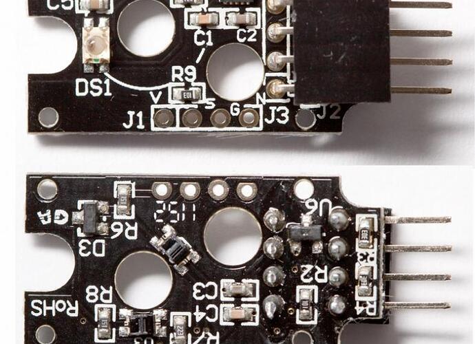

Guess I can post a picture of the guts :slight_smile:
https://vexforum.com/attachment.php?attachmentid=5179&stc=1&d=1327639271

So I hooked the new IME to another development board I had and wrote a simple test program to initialize the IME and then dump encoder data. It’s alive and works but notice a few issues to look into.
  1. Encoder data only seems to be 16 bit not 32 bit as the spec indicates
  2. Velocity data seems all over the place
Anyway, most likely my bugs, may be off on register access or something.

Ok, after a bit more digging it looks like the counter is 32bit but not with the byte order posted in the official spec, this is what I find wrt registers.
0x40 Rotation tics bits 15-08
0x41 Rotation tics bits 07-00
0x42 Rotation tics bits 31-24
0x43 Rotation tics bits 23-16
Top and bottom words are swapped, this is usually caused by big/little endian problems, could be two wrongs making a right in the VEX firmware, anyway, all other buffers I read are ok so assume this is how it is.
Velocity still make no sense, it keep also counting well after the motor stops.
I2C seems to work at both 100KHz and 400KHz.
It turns out that the velocity data is more like 1/velocity, or more specifically the time (measured in some unknown units as yet) between pulses received in the encoder. For example, if the motor is running at full speed the encoder changes by 473 counts/sec on my 269 motor, the velocity data is 269. If the speed is halved to 240 counts/sec then the velocity is 550. As the speed is slowed then the velocity number increases until the motor stops, the velocity data then just keeps increasing until hitting the maximum of 65535. VEX probably has a timer running that is latched and reset each time the encoder count changes, not what I expected at all, I would have scaled into something more directly useful.
Otherwise the encoder is working mostly as advertised. If you have never used I2C before then the posted spec is probably not quite enough to explain how to interface to it, I had to make certain assumptions based on prior experience. The only mistake I found was the byte order of the “rotation ticks” 32 bit word.
There is a comment in the spec about the LED being red when writing to EEprom, I had hoped that the scratch pad data might be non volatile but, unless there is another command to write EEprom, that does not seem to be the case.

It feels like the processor may be an STM8S103F3, a 20pin 8 bit micro, not 100% certain as the part number is not quite right. If that is the case then it has 640 bytes of true EEprom with a 300K cycle life, I would like access to that for parameter storage that we cannot do currently on the cortex. John, any thoughts? Is that the micro? Can we access the EEprom?
