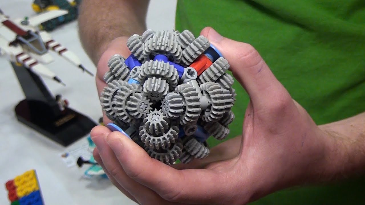

I guess, if the hybrid gears are like the Logo gears, then you could mesh them out of the plane and build something like this:
Hybrids are chamfered so that you can use them as both normal gears and at 90 degrees to each other like bevel gears.
Exactly. The new VEX IQ hybrid gears are combination spur and bevel gears. While the prior VEX GO Hybrid Gears were a larger gear pitch (16DP) in order to decrease the odds that gears could skip teeth without washers/spacers, the new VEX IQ ones are available in the standard 24DP gear pitch that is used in VEX IQ.
You can mesh the spur portion of the IQ hybrid gears with any other spur / rack / worm gear in the IQ system, and you can mesh the bevel portion of the IQ hybrid gear with any other IQ hybrid gear.
12, 24, and 36 Tooth hybrid gears will be available in the new 2nd generation IQ Competition Kit, and 12, 24, 36, 48, and 60 Tooth hybrid gears will be available in the pending IQ Hybrid Gear Pack that will be available for separate sale later this year.
