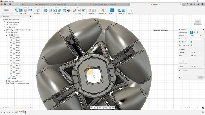

Hey. I’m wrong. Flip the omni face to face. Glad to find that the enthusiastic nutter on the internet hasn’t done as much work as the product developers.
Haha - there ya go!
It’s definitely not the most intuitive thing to describe over text, so we can chalk some of the blame my way, don’t worry! Glad to see you’ve got it figured out. Once you start playing with them physically, its easier to figure out the intricacies of the clocked bore.
Or it could have done if the offset of the hex bore was another 10 or 10.5 degrees off.
I see what you’re saying. Maybe we can explore this as a running change on the insert down the road… :thinking: :man_shrugging:
If I happen to spawn a neat solution, I’ll post it, but I imagine it will be sitting in your enhineers’ files somewhere already :slight_smile: Cheers!

I asked the product designer who worked on the 2" Omni Wheel to spin up a little graphic to help show some of the intricacies/secrets of the wheel. Basically, this graphic should help anyone else come to the conclusions @u89djt & I did above, albeit much easier. It’s relatively quick and dirty, but gets the point across better than any of my textual ranting has been able to. He even tossed in a trick that hasn’t discussed here yet - cutting the inserts to help create even more clocking positions! If you make two quick trims to the included inserts, you can quickly achieve the same 15degree clocking ability that is exhibited when these wheels are used on the 1/2" Hex Bore.
These inserts were cut using pretty standard diagonal cutters. Be careful & use safety glasses! The cut-off from our inserts went FLYING!

Oh hey, I have a dremel and an attitude - we could make 60 degrees happen if /really/ necessary :slight_smile:
Depending on the specific material, doing it with a cutoff wheel on a dremel or similar could be less ballistic because the plastic gets out of the way in a slower, more controlled manner. I guess it’s too small to use twisted duct tape as a tether to stop it flying.
Would cutting the inserts four times to have an entirely hexagonal flange weaken them too much? Wouldn’t have to worry about pairing them up then. Very fiddly operation. You could 3D print a jig to hold everything straight. People seem to be frantically eager to print things :smiley:
I will. After all, safety is one of my top 3 priories.
Ah, with four cuts, the inserts would no longer have a lip to locate them specifically along the shaft within the cavity, and the pair don’t quite meet in the middle. A continuous column of the omnis would place themselves though and there’s only a millimetre of gap. Eminently hackable!
