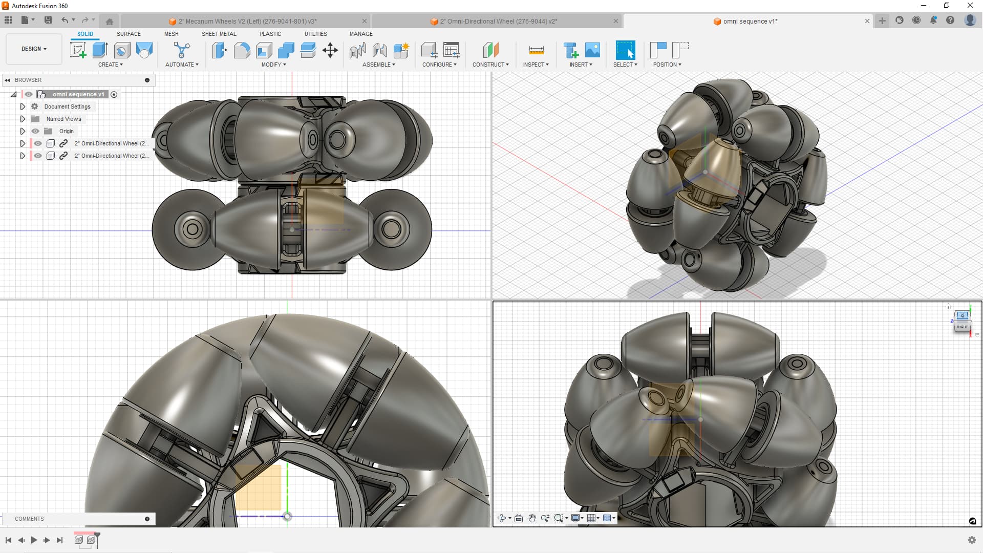

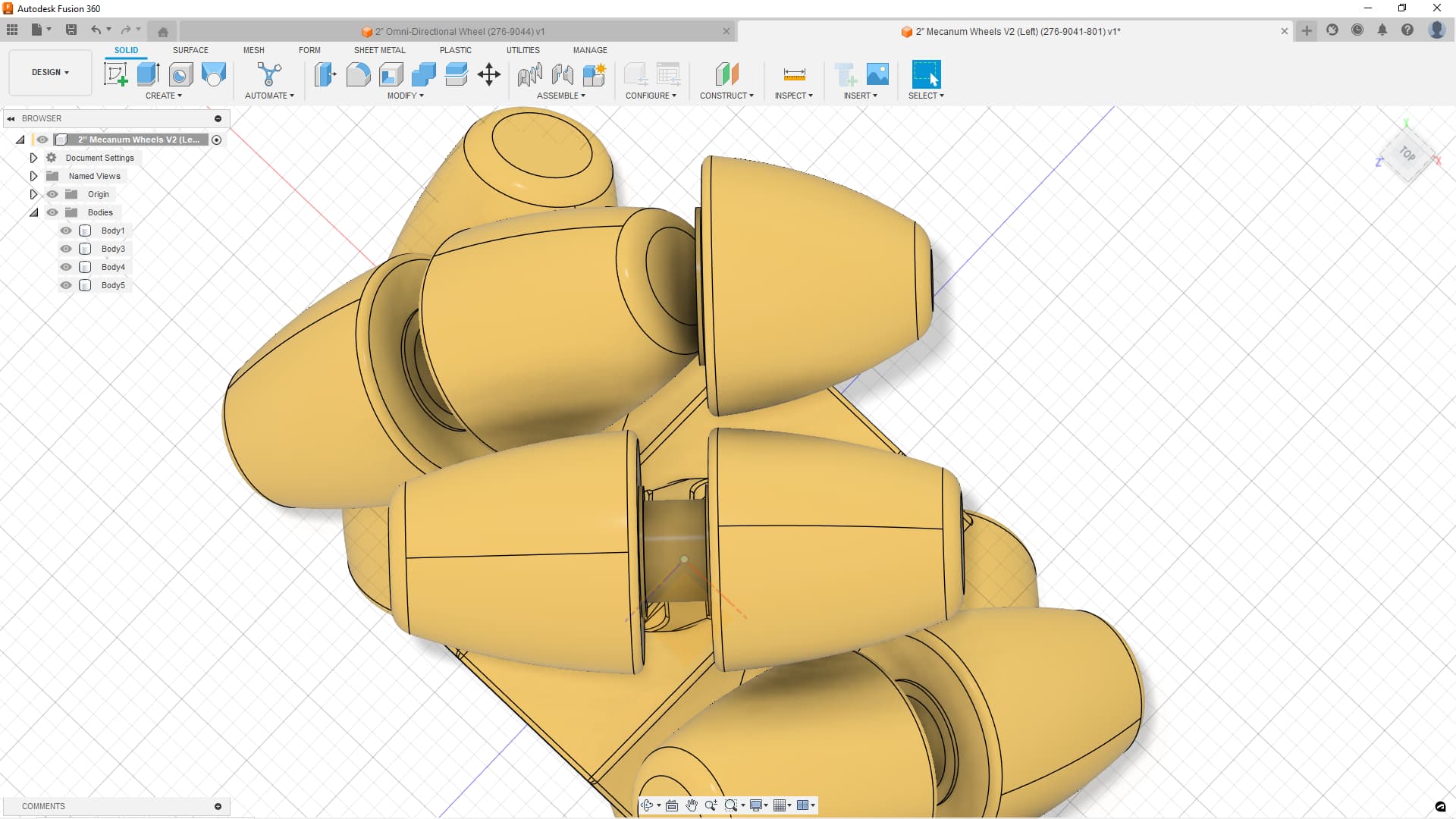

The mecanum wheel CAD is rough, but it doesn’t look like the rollers are the same.

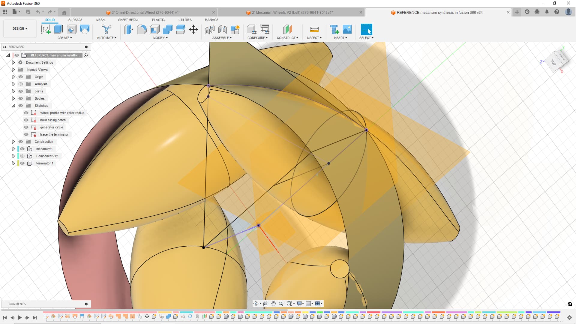

  1. Nope!
    Omni and 45 degree mecanums have different kinds of profile. An omni roller radius along its axis is the outer circle minus a constant. A mecanum roller’s radius is subtly different to what you are expecting at least three times while grinding through the maths to actually make one. There is a relatively simple way of making them in Fusion 360, though, once you spot a trick or two. I’ll post my Fusion 360 method when I’ve got round to garbage-collecting the failed attempts.
    I assume it’s also similarly easy in Solidworks and others - I haven’t tried.

@u89djt Thanks for the pictures and the math lesson! It’s pretty easy with the diagram to see the difference between the two.

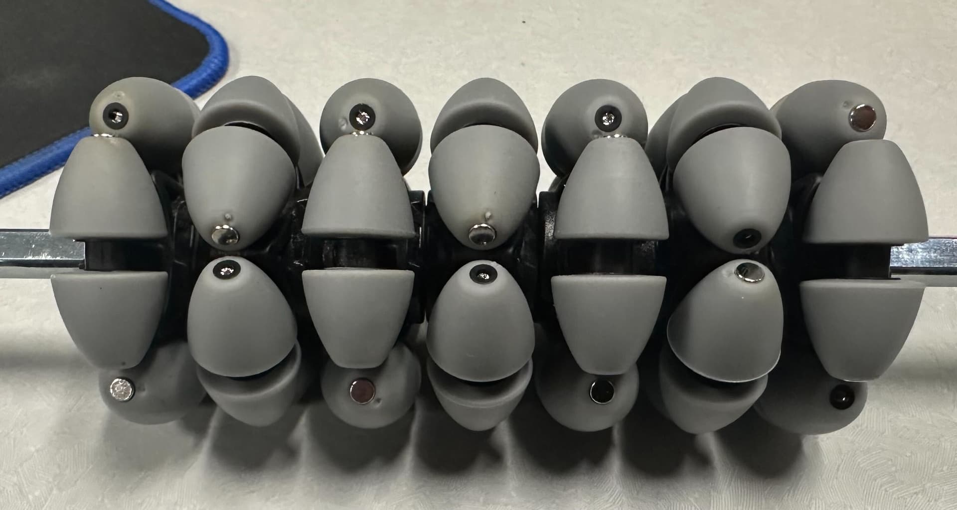

Because the Omni Wheels were designed with intake applications in mind first, they are designed such that you can clock the rollers along a shaft. The bore is not perfectly clocked to the rollers, intentionally. A fully assembled roller with these wheels can be made with offsetting rollers, helping to smooth out the “gap” you’re worried about.

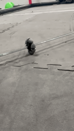

And in all honesty, they still roll pretty well by themselves

Glad you’re in better shape. We should say out loud that the gaps in the rollers are actually lined up in that shot. You need an offset more in the region of 60 degrees to place the gap coincident with the main surface of a roller. I wonder if that could be achieved with a combination of adaptors? The one that comes with the wheels can’t break symmetry, I think, and so only gives you 180 degrees offset, which doesn’t change the profile.
In a drive scenario, since it doesn’t matter where the wheel lies along its intended line of action, you could have a synchronized pair in line but offset by whatever angles the gearing will allow and that would hand off lift duty during gaps.
Yeah, unfortunately the 1/2" Hex Bore allows for better clocking than the 1/4" Square Bore. Sacrifices had to be made somewhere when we decided to try crossing two hurdles with one jump.
Yeah, this will help alleviate the concern here as well. But I will say that I believe the gaps look worse in pictures & CAD than they actually are in reality. The wheel rolls pretty true.

Yes, they’ll rattle past very quickly to the extent that momentum and flex in the system is unlikely to care much in the overall behaviour, but bearing wear will be higher.
Oh hey, I have a dremel and an attitude - we could make 60 degrees happen if /really/ necessary :slight_smile:
