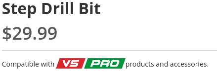

Actually wait what it’s $30??? Literally why.

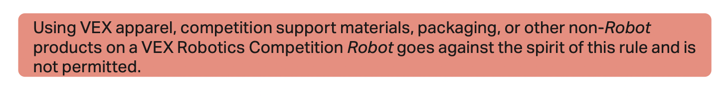

To pay for all the lawsuits when students put this drill bit which is, for some inexplicable reason, VRC legal on their robots.
Not to be that guy, but I think the red box rains on that particular parade:
Additionally, products meant for use on finished robots contain an additional “VRC Legal” tag which is missing from your screenshot above, for example:
Although I notice that the V5 logo is now missing from the step drill bit product page, for me at least.

$30 for a $9 stepper bit?
While I have seen a lot of comments on how much more expensive this is than HF step drills, the listed price is actually not out of line with many retailers. If you look at your typical home improvement type store, you will probably pay a bit more than $30 for a similar bit…
For a school that already has VEX as an approved vendor, this is actually a decent deal.
Its a good thing vex isn’t your typical home improvement store. If i wanted one now, i would pay the 30 at home depot. If i didnt want it, and i was willing to wait, pay for shipping, and then finally be able to use the tool, i would order off amazon for 30% the price and much cheaper shipping.
It’s $53.25 for us non-Texans (tax + FedEx) now that VEX resellers were declared competition illegal. For one singular bit. They better be made out of anti-static vibranium with built-in velocity PIDs.
