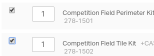

This does not include the mat or field perimeter - it only includes the season-specific components. You also need these:
This brings a new field to a total of US$1529.94 plus tax.
Not sure if we can afford the perimeter kit. Can the kids complete some challenges with the $500 field kit and the $900 starter robot minus the perimeter kit?
