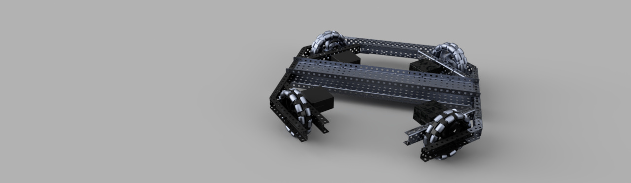

Thanks for all the help, i got an x-drive CADed!

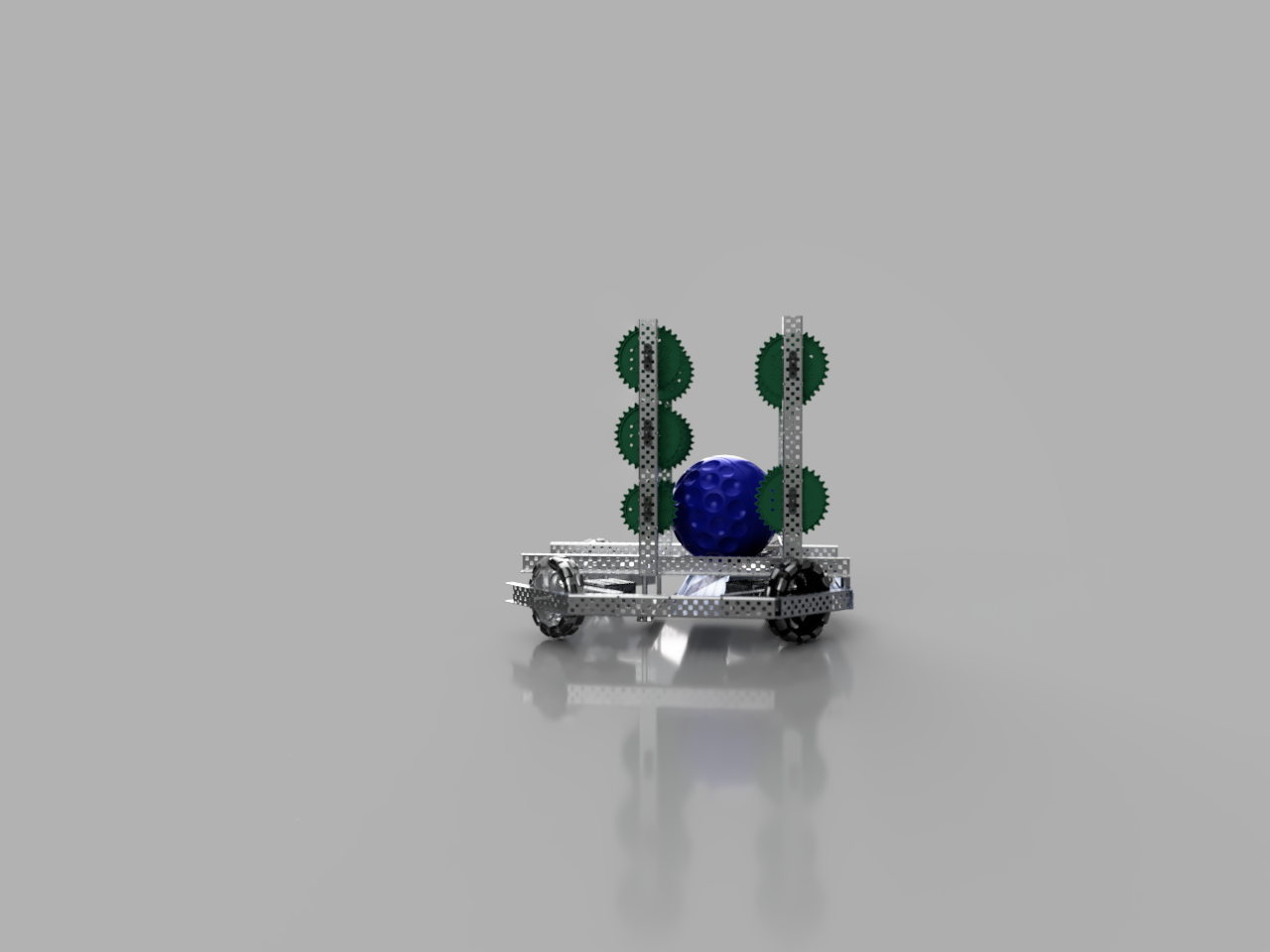

Alright, So I have made some progress.
I know that the render is kind of far away (I’m still playing around with the renders), but do you have any recommendations on it? It’s not finished, of course, I still plan to add bracing between the roller towers and the motors and chain for them too, and the intakes of course. I’m a little worried about the roller placement though. any recommendations?
E: the 5 wide brace at the bottom is clipping into the ramp, but the 5 wide is upside down. I mean to fix that.
E: The back rollers are set up to be a pooper.
a good way to find out the desired roller placement, and to use cad to do it is to first figure out the path that you want the ball to take. what I did was make a bunch of balls and just build the path I wanted using the balls, so I ended up with like this slug made of balls. then I built the rollers around them so I could be sure that they would have the compression and spacing I wanted them to.
