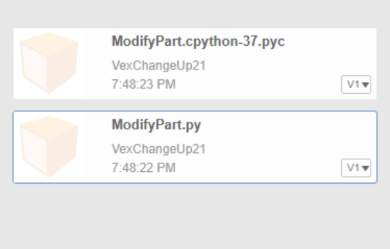

So I downloaded the Add in, and when I search for modify in the downloads, I see this:
Screenshot 2021-01-09 195418
Is this what I should be seeing? because It’s not doing anything.
Did you download and install it properly?
Seems as you had installed it as a part. Try reinstalling it following this written tutorial by the team behind the parts library.
Downloading the add in is a bit tricky. You don’t upload the file into your project like you would do for vex parts. The steps are in this written tutorial that is also part of the Parts Library Release post linked above: Installation
So on the tutorial, it says that I can add them in with the Addin button on the main toolbar. But I don’t see that on mine. I just updated F360, too.
The tutorial we linked to was not made by us. It was made by a guy who who works at autodesk that as a side project created apper (the that framework significantly aided the development of our add-in)

I tried googling, result is that add-ins got moved to the “tools” toolbar

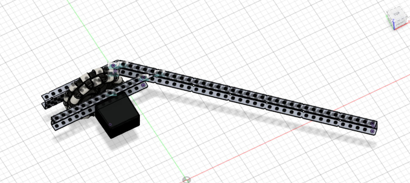

So, I had schoolwork this week, but today, I sat down and started an x-drive cad.
I want to copy and move the pod area so I don’t have to redo it all. How would I do that?

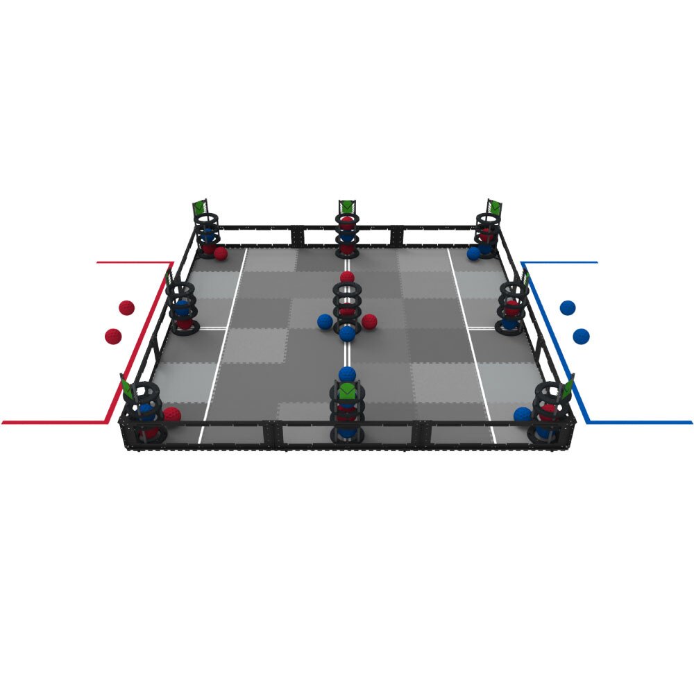

Also, does anyone know where I can download the file of a ball?
From the VEX website.
I found the field CAD file .STEP and downloaded into Fusion. Is there a way I can Isolate one ball? It views all of them as part of the field, and I want to get rid of the field. I saw this post
But It all shows up as one part in the browser.
