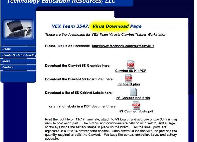

If anyone else is using the Clawbot system for similar training, our team would like to offer you instructions and printable pages for building your own trainer(s). Here’s the link to a web page with the downloads:
http://www.technology-education-resources.com/22514.html

Had to laugh when I saw the title of this page, not sure I want to download any viruses.
[ATTACH]9490[/ATTACH]
LOL. I’ll get the web page edited a bit.
