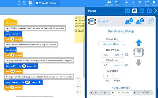

Use this URL to do some testing: https://codev5.vex.com/
Open up the examples (under the File heading) and look for the Waiting Between Commands project. You can set up a simple drivetrain and the drop blocks under the yellow events tab.

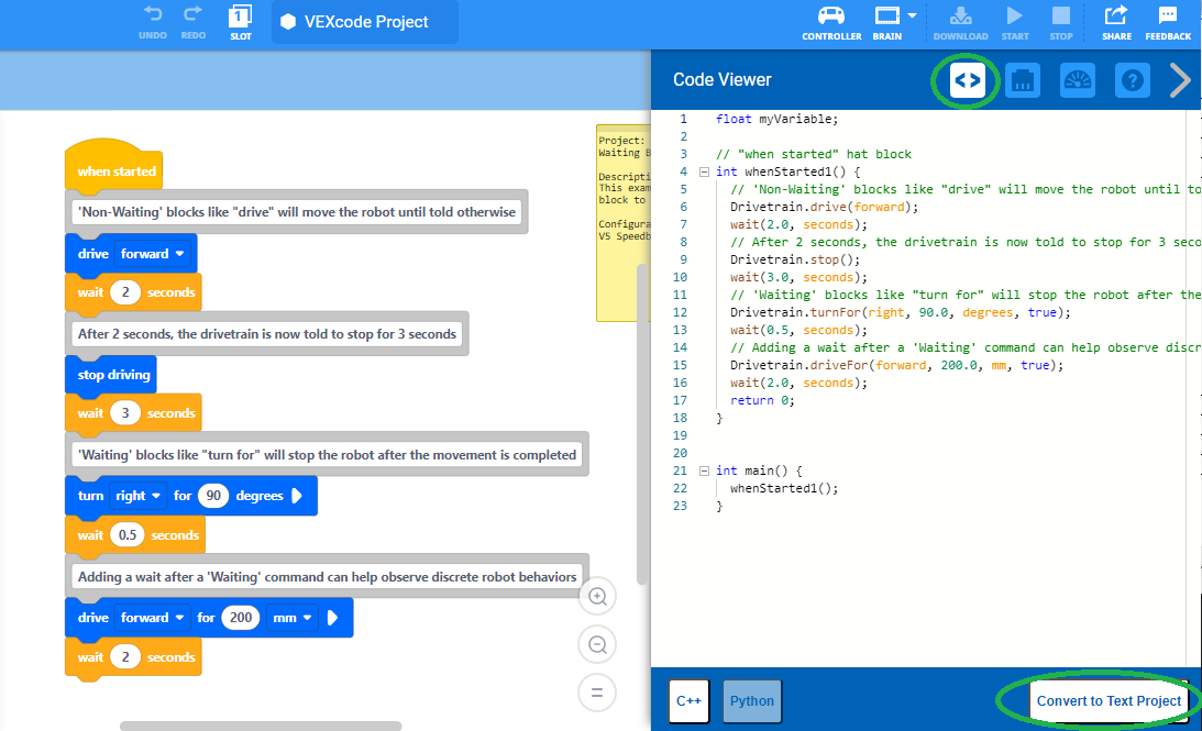

Click on the code preview button in the upper right and you will have c++ or python examples of your sample code as a reference.
You can even convert it to a separate text project as a boilerplate to get you started.
