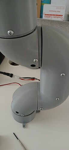

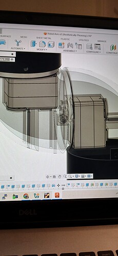

This isnt a vex robot, but i wondered if anyone could advise on how to reduce the way the arm is sagging at the joint, this is a 3d printed part that is screwed into a servo, i tightened it and made sure when i designed the partnit was flush but the weight of the arm seems to be pulling it away. Any ideas?

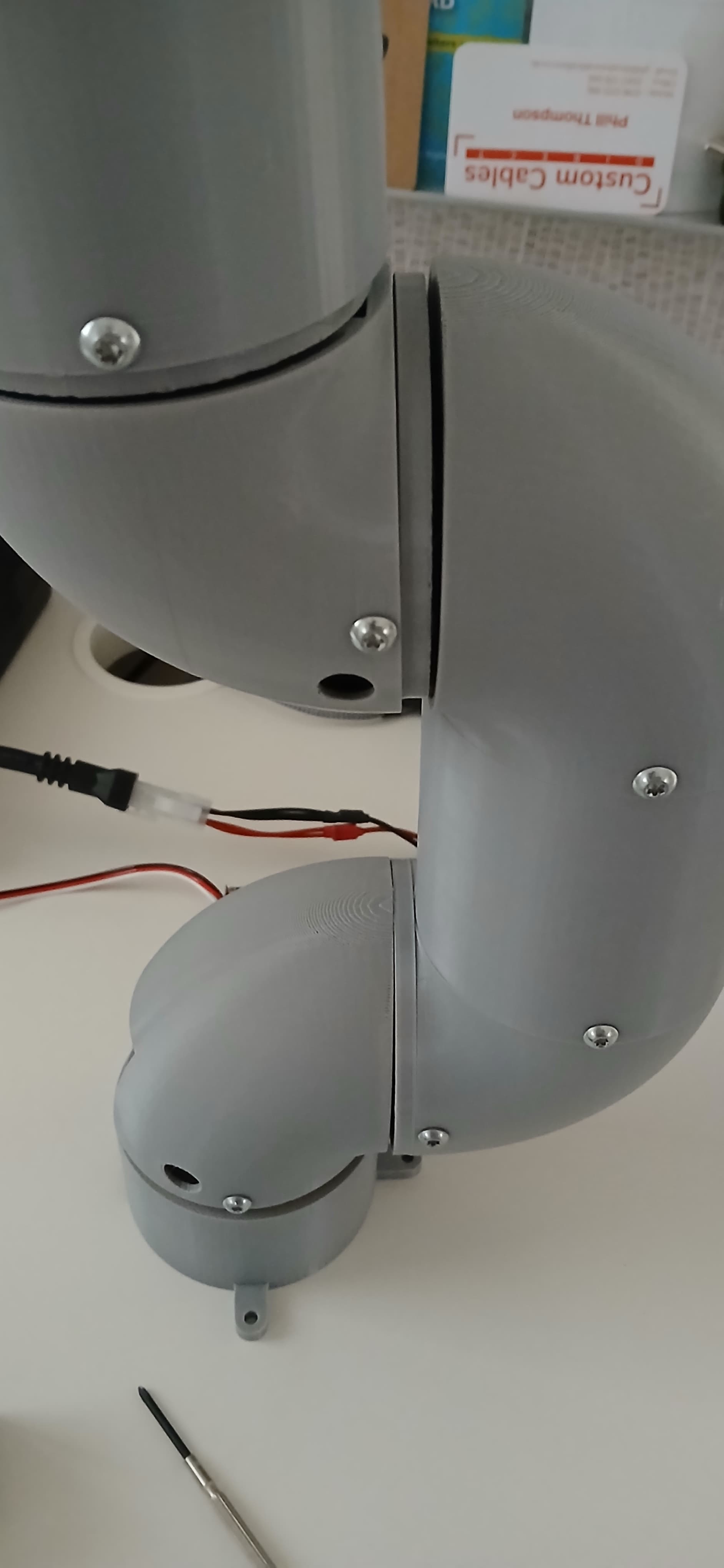

I have sent another message with an image, but the problem isnt the servo sagging, but with the material coming away from the servo, qs you can see in the gap in the image.

I see what you mean if the problem was the servo not being strong enough, but this is more to do with the material sagging, i have tightened it and it should be flat against the connecting part, but the weight causes it to pull away. Im not sure what to do, stronger material? Some kind of bearing?

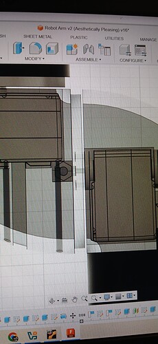

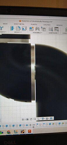

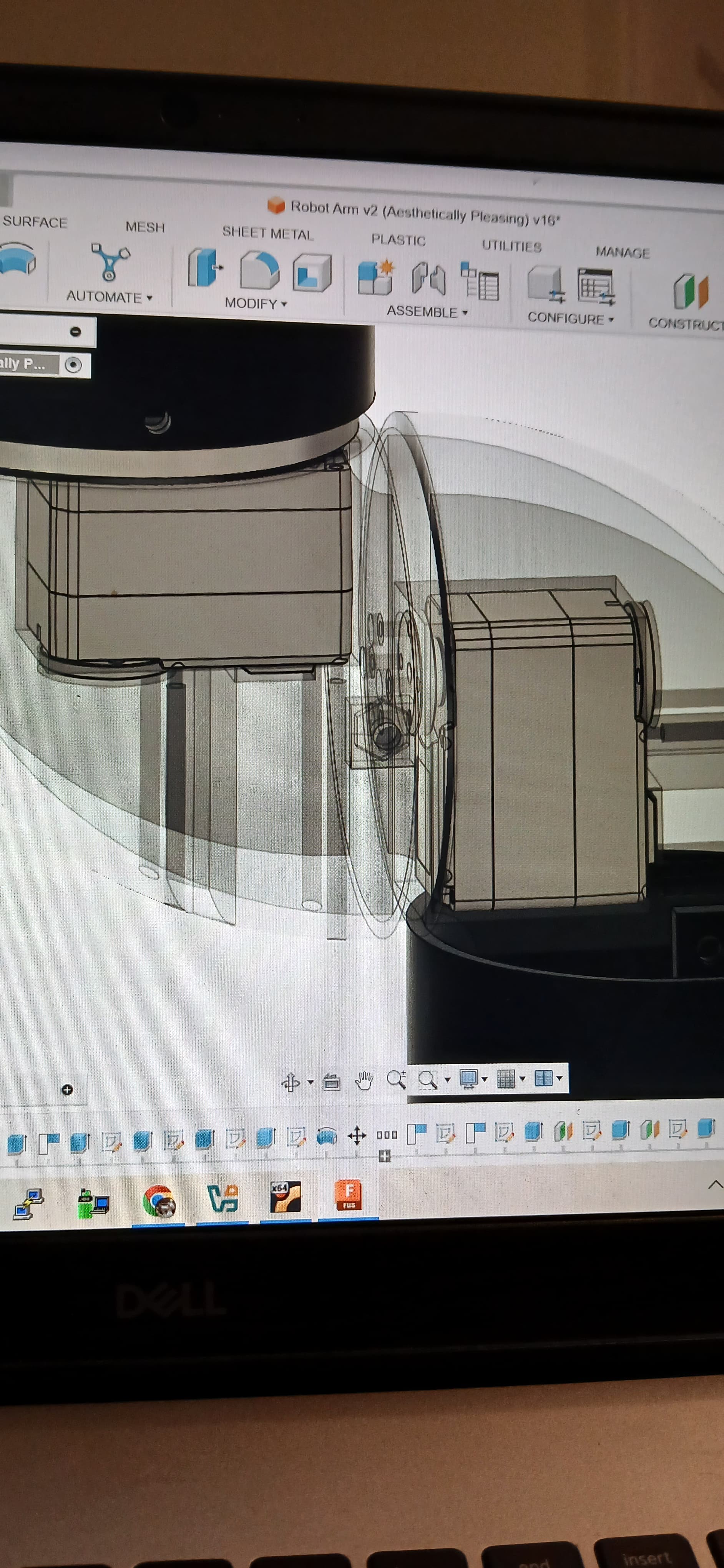

Can you forward us some transparrency mode cad screenshots? If the internal support structure is cantilevered it is practically guaranteed to sag.
Let me know if you need better pictures

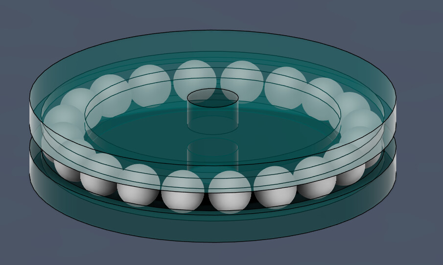

I recommend using a thrust bearing for projects like this. On my recent robot arm—3D printed and driven with VEX electronics, gears, and shafts—I implemented a custom thrust bearing. It consisted of two sides with grooves cut out and 6 mm airsoft BBs as rolling elements. This solution was super cheap and worked surprisingly well.

Thrust bearing with the bbs is a great idea, thanks! Glad it isnt too expensive as well, already breaking bank with the servos and custom wiring.
