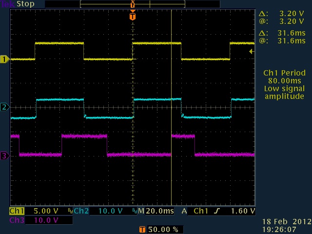

Two motors, one on port 10 the other on port 3 are switched between full forward and full reverse speeds. A digital output is set to indicate which speed has been sent to the motors. The scope trace below shows the resultant motor drive signal on one side of the motor, the blue trace (ch2) is for the motor on port 10, the purple trace (ch3) is for the motor on port3 but is measured after the motor controller 29. The Yellow trace is the digital output and is used to trigger the scope.
It can be seen that the port 10 motor responds to the speed control almost instantaneously but the port 3 motor has a variable delay between the requested speed to the resultant change in speed. At the trigger point the delay was measured as 31.6mS, however, this is just one example and varies as predicted in my other post.

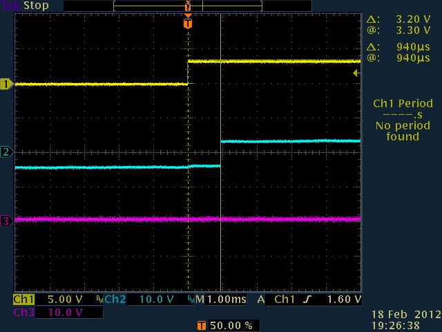

This trace shows the delay from speed request to the motor 10 output with an expanded timebase.
The delay is typically around 1mS and is probably due to the ROBOTC task management.

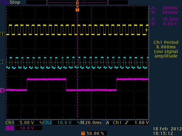

The difference is that the delay between requesting motor speed changes has been reduced from 40mS to 4mS.
It can be seen that the motor on port 10 is able to keep up with this increase in changing requested speed, however, the motor on port 3 is not able to and changes randomly depending on the relationship between the motor speed request and the SPI message being transmitted to the master cpu.

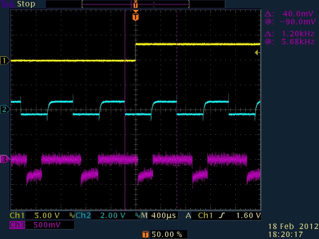

Finally this trace shows the PWM signal going to both motors when a constant speed of 64 is requested. The pwm frequency is about 1200Hz for both. The signal to the motor on port 3 looks noisy due to lack of grounding to the scope.
These tests were done using ROBOTC but I would expect the same result using EasyC, this is not dependent on the user code but rather the way user processor and master processor communicate. It’s interesting that the duty cycle for the port 3 motor is not the expected 50%, if I have time I may measure the no load speeds of the two motors to see if they differ, but that will have to wait until tomorrow.
I post this just as information, in practice this has no impact on any competition code that anyone is likely to be running.

Paraphrase jpearman’s quote above for my own understanding: Scope1
Yellow is digital output: 40ms swaps from 3v to 0v for motor -127, -127.
Blue is port10 red wire: 0v in center line, swaps +,-v closely with Yellow.
Purple is #29MC red wire from port3: swaps from +v,-v with variable lag from Yellow.
  • Lag sequence is 20ms, 19ms, 31.6ms(shown), 10ms.
Scope2: port 10 update delay ~= 1ms
Scope3: try to update motors +127,-127, +127,-127… every 4ms:
  • port10 can follow well.
  • port3 through mc#29: Wow, motor stays in one state for 40-60ms at a time.
** I’ve seen some competition code with “lock motors” routine, that does rapid +127,-127 updates. I’m not sure of the original intent, or its wisdom, but these results might matter there.

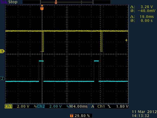

Firstly, all pwm signals are synchronized, I compared motor 2 to all others.
Secondly, here are a couple of scope grabs showing the SPI comms wrt PWM output. The yellow trace is the SPI chip select signal, the blue trace is a PWM signal to a motor. As I had surmised, the SPI runs every 19mS whilst the PWM every 18mS. This is with EasyC, the ROBOTC timing is as I originally posted.
[ATTACH]5464[/ATTACH]
This is the same thing but with a different timebase.
[ATTACH]5467[/ATTACH]
Terrific. Would you agree with these conclusions of your EasyC data ports 2-9?
  • 90+% of the time, there is a 1:1 matching of SPI update to PWM update.
  • For a randomly timed SetMotor, mean time to SPI update is ~10ms, 19ms max.
  • For a randomly chosen SPI update, mean time to PWM update is ~10ms, 18ms max.
  • Therefore, for a randomly timed SetMotor, mean time to DCchange is ~20ms, ~40ms max.

Seems about right.
