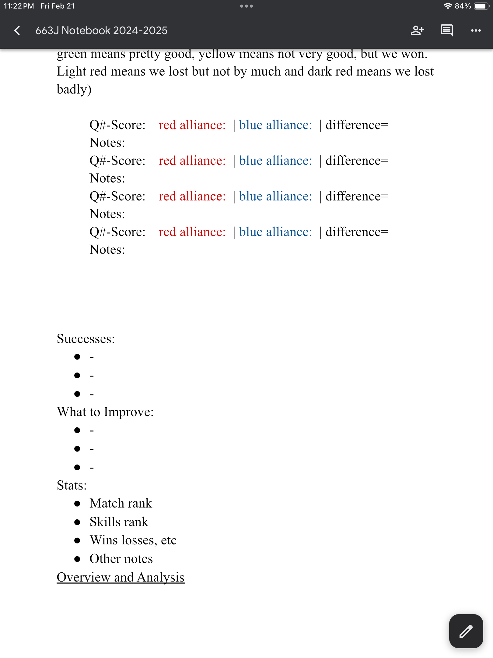

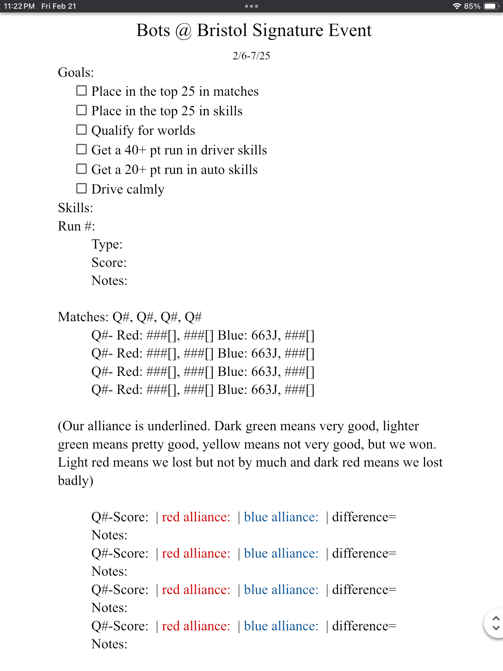

For us, we created our own template. Adding illustrations and color just helps to break up the monotony of black text w/white bg. We use Google Docs for our notebook. Also I forgot to mention to condense what you can into bullet points and such. Here’s a few pics of our notebook (it’s not very good, but might help you) (sorry for the bad images I’m on an iPad rn)
Here are just some ideas from what we do. 1 is a picture of a more recent research page, while the other 2 are our tournament template. Good luck.
