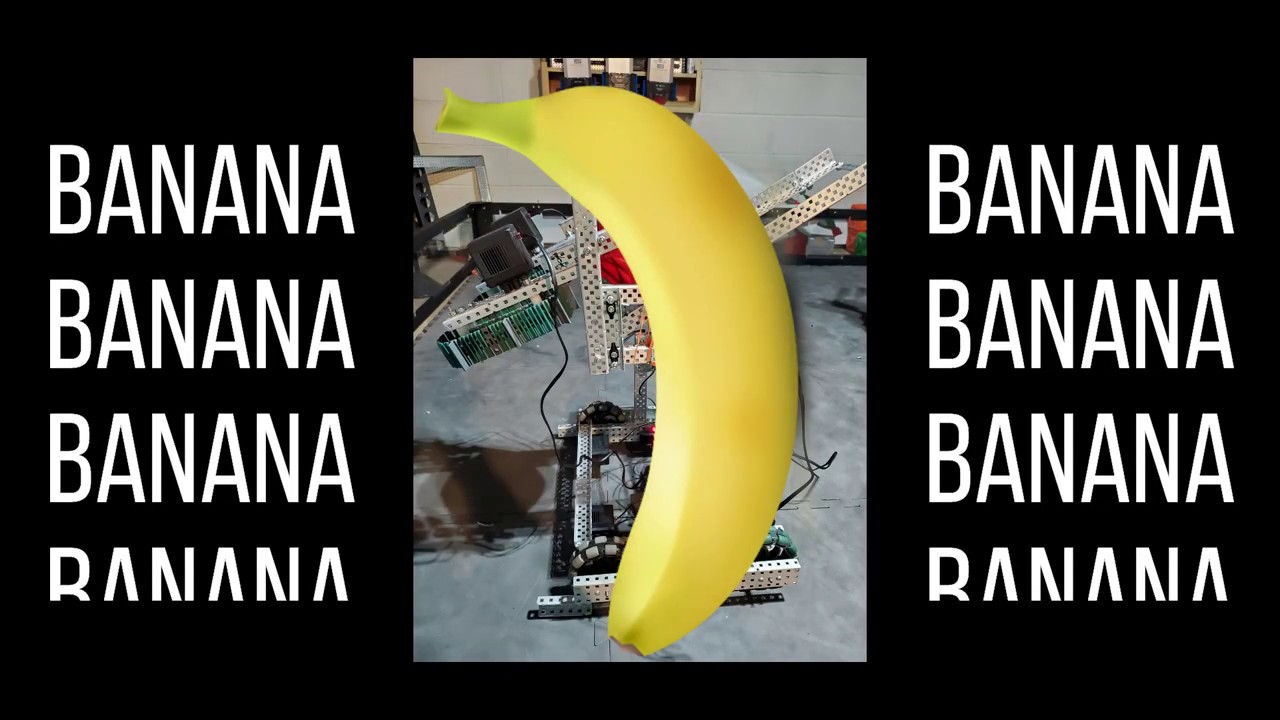

we build a ri3d (first time and we had limited resoursed because germs)
specs:
2m intakes
2m dr4b
4m drivetrain
also i know building a snail would have bean better but i knew how to make lifts good from last year and @Micah_7157X knew how to do a tray from last year so we figured this would be easier to do in 3 days
also huge thx to @dkobasa and @Micah_7157X for coming over to my place and helping me especially @Micah_7157X who aint even on my team

you did imply it, and you added nothing to this conversation much like what I’m doing until this point where I want to say good job building a robot in 3 days can be a hard task there are def ways to improve the robot such as bracing your lift be it X braces or boxed C channels and the intake may need a litlle more work
You know if you lower the intake a little bit it might grab easier. Also some extra bracing on the intake might help, the flimsiness seems like it’s ruining the compression a bit. All and all it has some build issues, but the overall design isn’t bad.

We did not have a bunch of parts so we have to improvise. The #1 problem is that we did not have a full sized High Strength Shaft.
