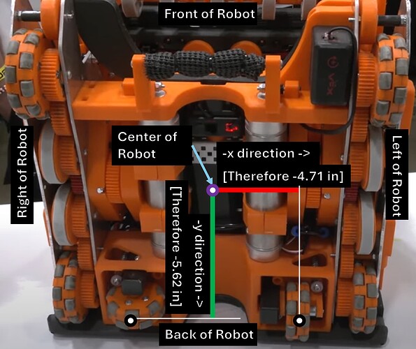

This is misleading. If you’ve read the Pilons doc you know that this point is basically meaningless. Instead you can just pick your tracking center first, measure to each tracker, input those measurements into the code, and call it a day.
Honestly, I did read the Pilon’s document but I was unable to fully understand it. One of the common problems Is trying to accurately provide a degree of explicitness so that it is easier to digest. I have created an example image below, trying to understand what you’re telling me. The measurements are made up but are simply meant to exist to provide context. Would this diagram be correct, such that if inputted into the JAR-Template or any other template it would work no problem?
Yes, that’s exactly right.
