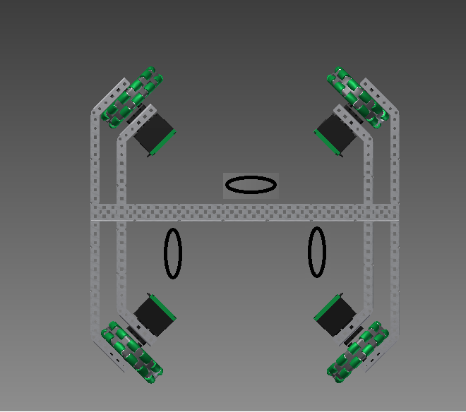

would this configuration of the tracking wheels work with a holonomic drive? (the black ovals being the tracking wheels )

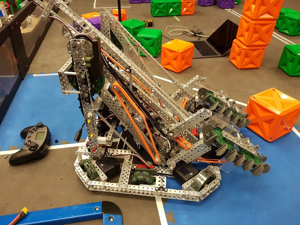

Yes, that would be good. You can see the setup used by 5225A (offically #2 in skills this year) here:
More pictures and videos of that robot are in this album if you’re curious.
thank you!!!

Note that the accuracy of your tracking is increased as the left and right tracking wheels are placed farther apart.
This is due to an increased rotation of the tracking encoders for each arc approximation of the robot. (I believe this is the case, someone please correct me if this is wrong.) ![]()

i believe your reasoning make sense thank you
