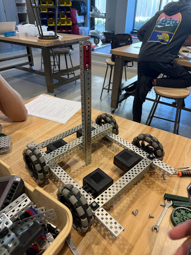

My team is doing a single-support lift sorta like an elevator on motorized rails. I’ll post an image of the working design below:
This was taken today but we’ve already started modifying this design so it will look a little different in any later pics I post. Also yes, I know, our drivetrain is hideous. We’ll fix that, I promise. It’s a work in progress.
