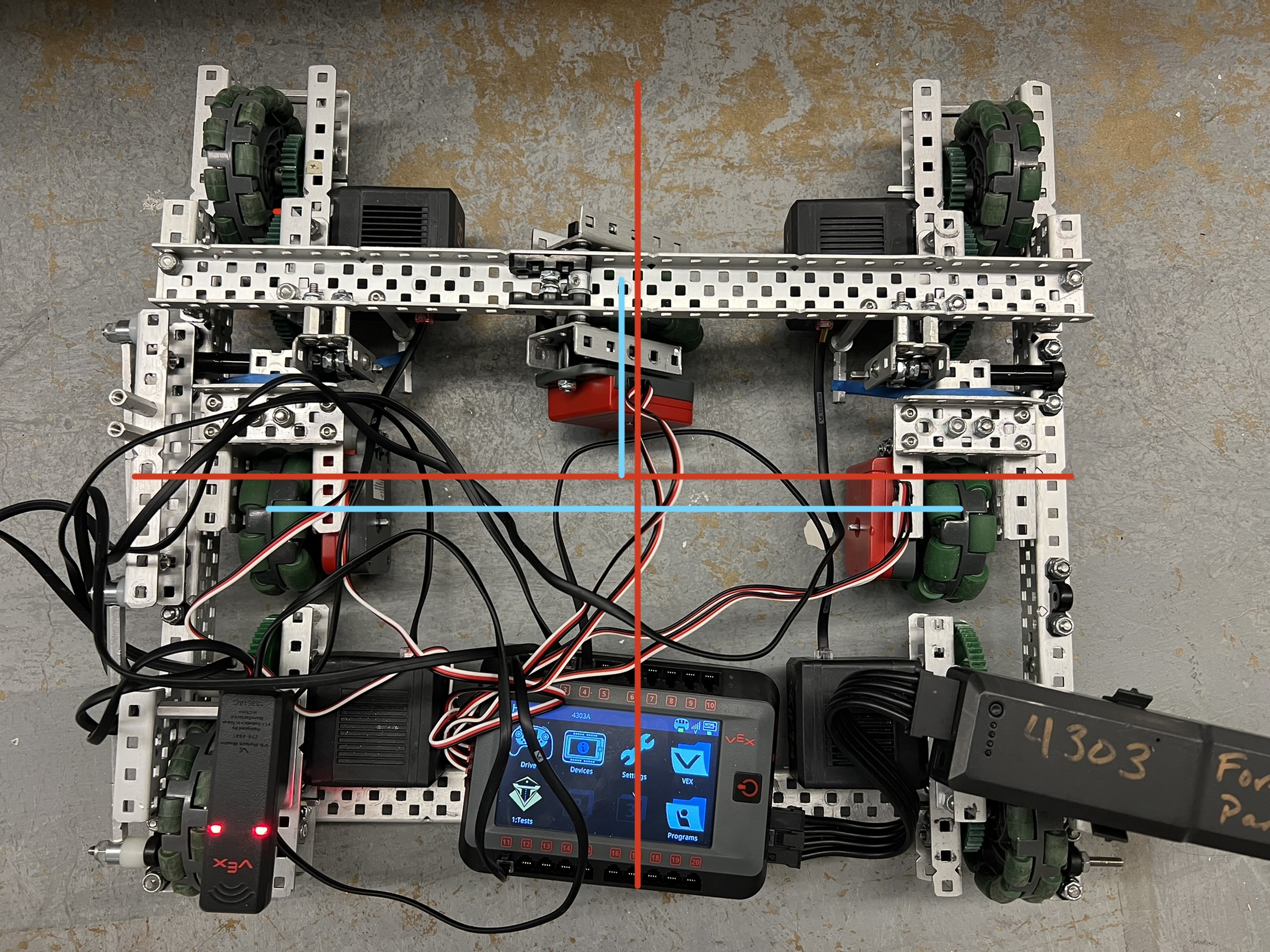

Picture of the bot:
Blue Horizontal represents the “wheel track” = 12.20 in
Blue Vertical represents the “the length from the center of rotation to the middle wheel” = 3 in
All tracking wheels are 2.783in in diameter
Hence: ChassisScales scale({2.783_in, 12.20_in, 3_in, 2.783_in}, quadEncoderTPR);

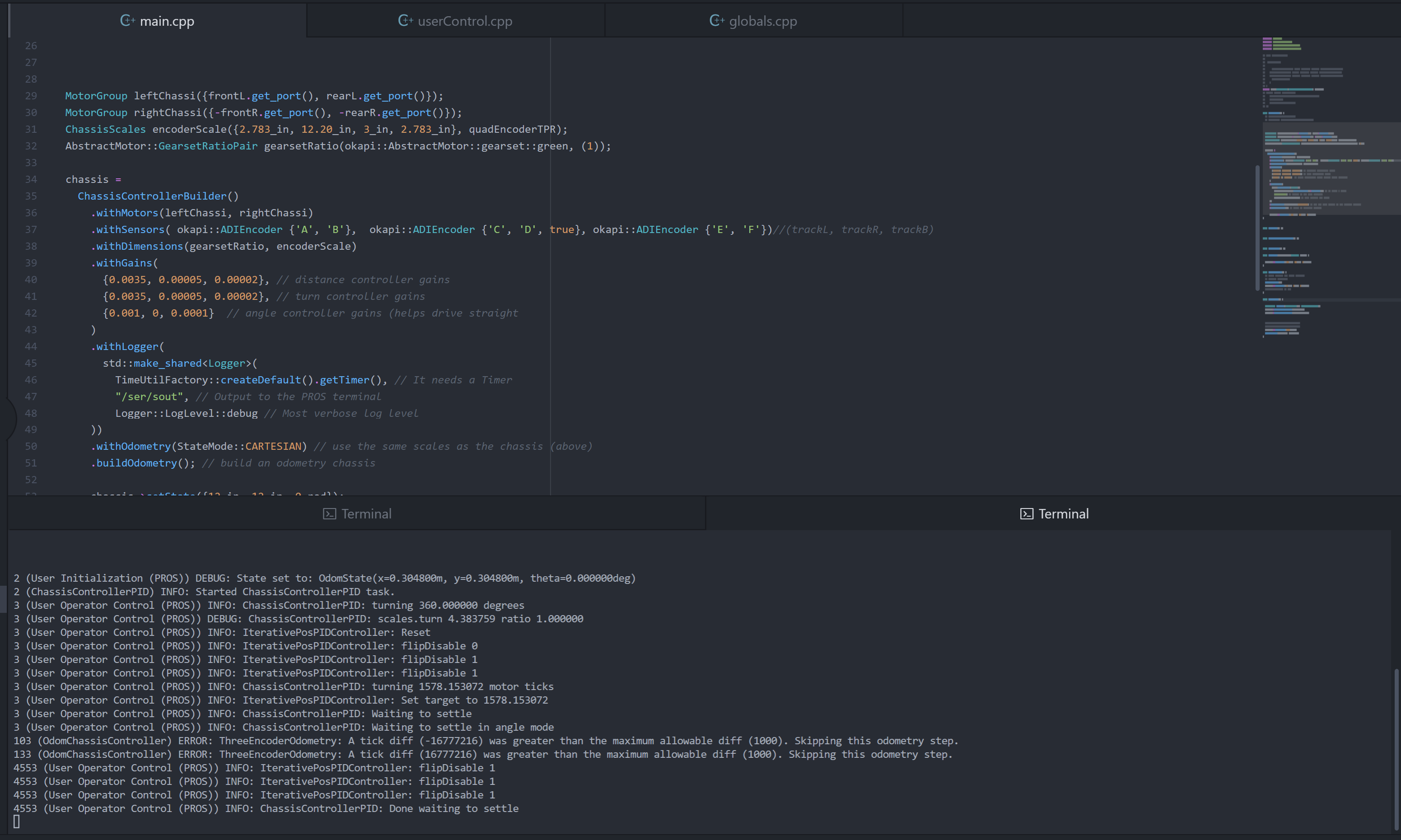

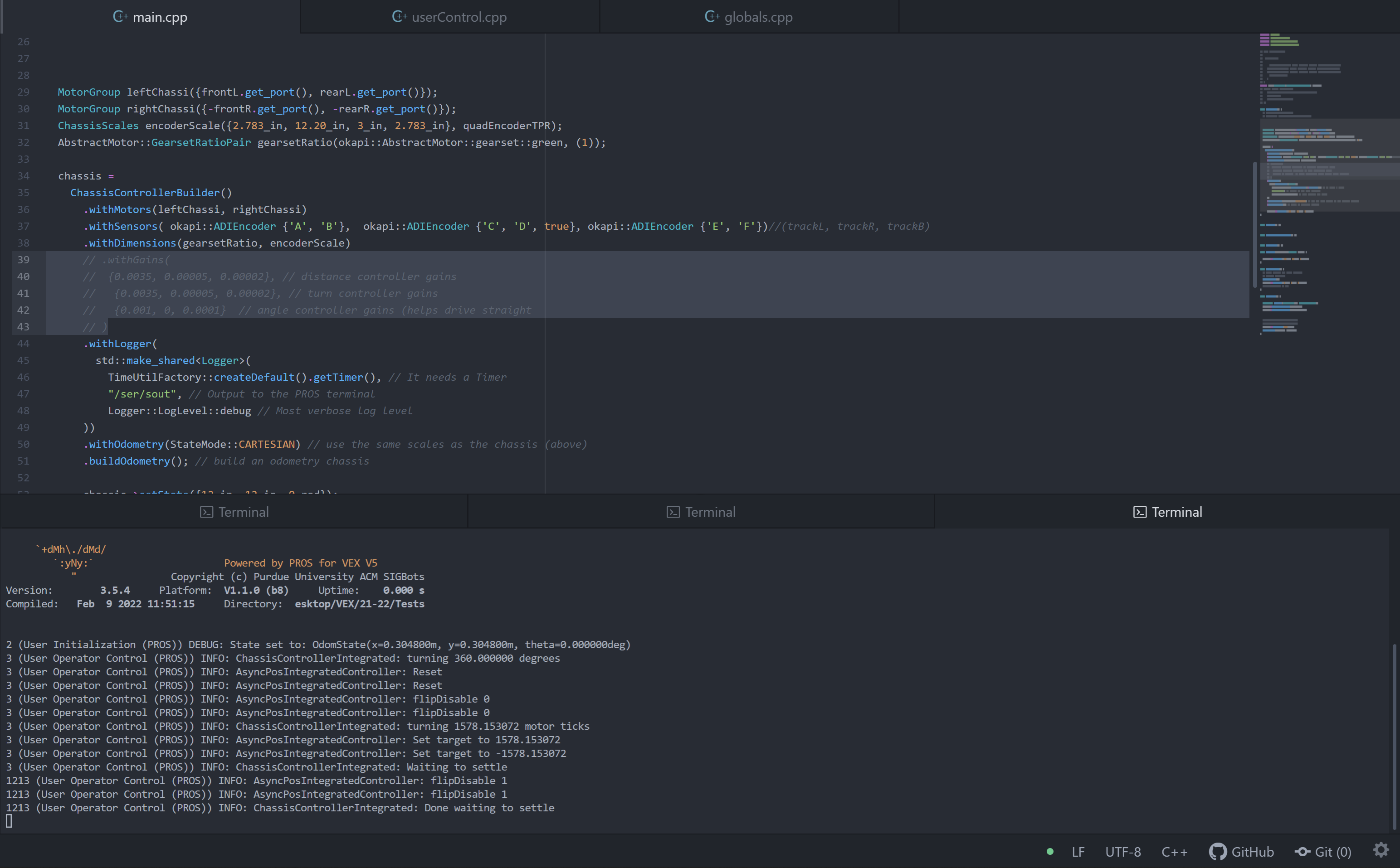

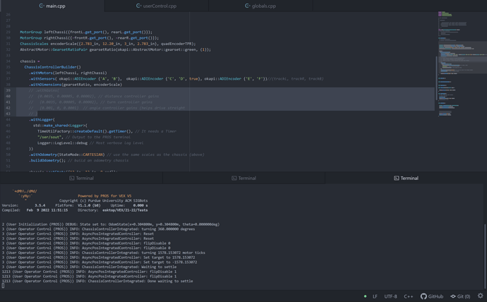

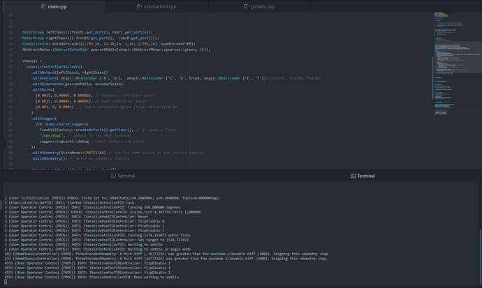

So here is the debug with & without gains (everything else is constant).
With Gains:
Without Gains:
As you can see, the tick value is the same, however since it uses a different type of controller, it takes values from the motor encoder if gains aren’t present.
For ChassisControllerIntegrated, the odometry value is taken only once. For example, if my current global position is -30 degrees, and I want to turn to 90 degrees, it will simply tell the robot to turn 120 degrees using internal control with no further odometry feedback.
When the gains are supplied, a ChassisControllerPID is built instead. Like the previous case, if my current position is -30 degrees, and I want to turn to 90 degrees, It will set the PID target to 120 degrees, and use motor encoder as feedback to the loop.
As you can see, Okapi’s Odometry control doesn’t actually use Odometry to its fullest extent. It is perfectly possible for you to run Odometry constantly as feedback, instead of only being taken once. If you would like to do that, you would have to implement your own functions (or create your own odom controller) if you want to achieve that.
