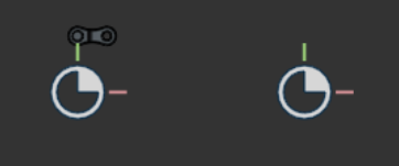

Hi all,

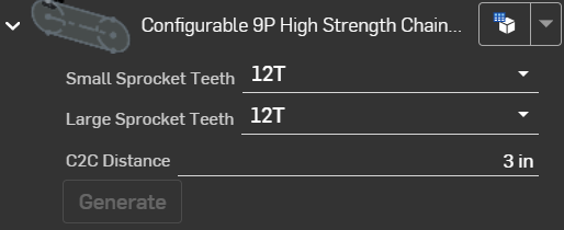

I am doing a CAD on Onshape using the VEX V5 Parts Library, and for whatever reason, with the specific length of chain I need, the config. glitches out and only shows one link of chain. If I shorten/lengthen the chain by any amount, I don’t encounter this problem. I am going to leave the chain out of the design, but does anyone have any idea why this is happening or how to fix it?
Thanks!
I think thats an issue with the part folder we are using but an easy solution is to set the c2c distance to as close to 3 as possible (3.007 works) . That issue is pretty strange though cus it only breaks with 3" with thoes 2 gears exactly.
