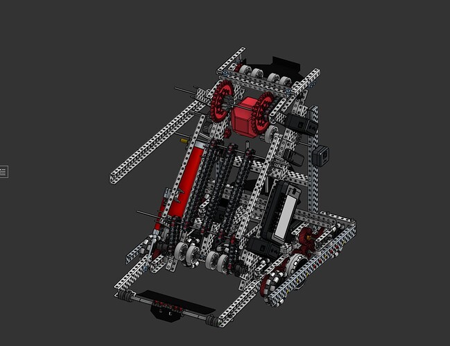

Onshape Design Reveal of our team for Push Back
Drivetrain:
-6 11w Motors (geared to 450)
-4 3.25" Omni-Wheels
-2 3.25 Traction Wheels
-3 Odometry Pods
-Little Willie Mech
Intake:
-2 11w Motors (1:1)
-Linear-type Intake
-Aligning mech
-Descore Mech
-Color Sort Mech
Ask any questions, this was done by myself and there is still more hardware to be added (Screws, nuts, and spacers)
Also, all the Motors are 600 rpm, and for now, the whole robot is only using one pneumatic cylinder
What’s the vision sensor over here for?
is there a reason you are using a vision sensor instead of just a distance sensor for your positioning in skills?
its a gps sensor, for auton positioning
This robot wouldn’t happen to be inspired by some team specifically at mall of america righttt? Surely not… Anyways nice cad, would recommend another crossbrace tho
Ooohhhh, that makes more sense.
lol you are right, it’s a good base to start off with, and because it’s my first year ever with cad. Also, the robot isn’t fully done yet, so there is more stuff to add. Thank you for the suggestion!

Nice job! I would recommend looking into adding wings near the top of your bot though. I would also recommend changing your brain placement as well as maybe adding plastic near your hood to act as a funnel or else blocks can potentially jam into the sides. (Speaking from experience). Finally I would also recommend adding plastic near the front of the bot to act as a funnel into your intake or the blocks will just be the edges of your drivebase.

Thank You! Also this was just a design that I made to base off for our robot so we could build quickly, we are in the process of putting on both the winds and something to funnel the blocks for the intake, we did add mid stage funnel too right after I posted this.
