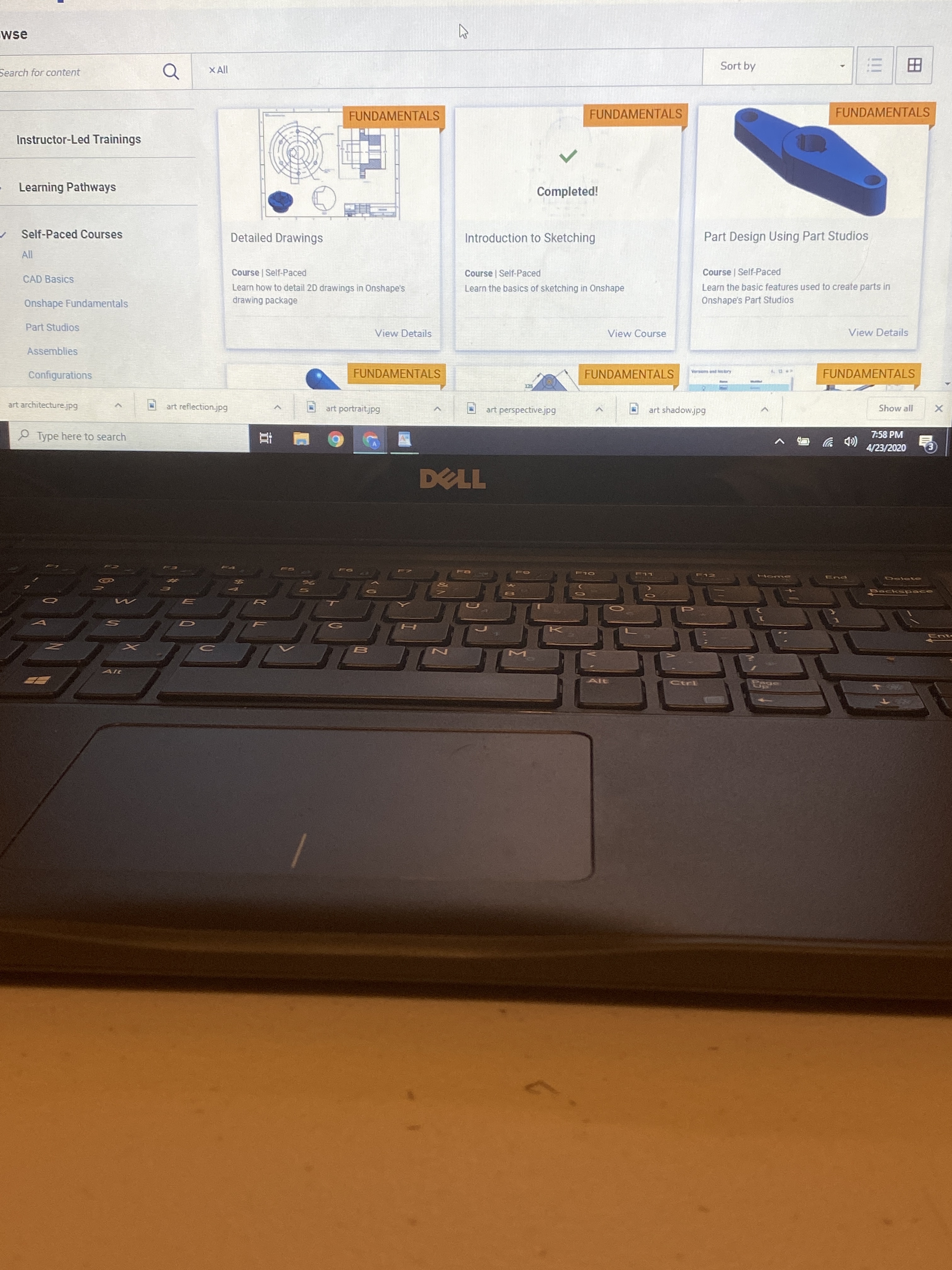

I need help with the basics of onshape. I’ve never used CAD and I only have a chromebook accessible. Any help is appreciated.
Onshape actually has a very thorough online curriculum. If u go to the website and place your cursor over “learn” and click on “learning center” you should be redirected to another page. On this page, clack on “self-paced courses” and then click on “all self-paced courses”. This should take you to a page with multiple video tutorials on all the features of onshape. It looks like:
