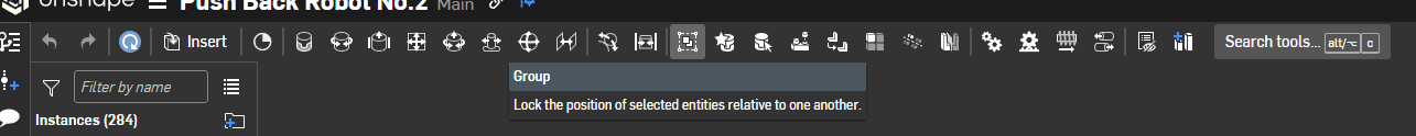

I am working on a CAD for my robot. Whenever I want to move parts, the most efficient way is using mates, as it perfectly aligns the instance with whatever i need it to. But adding mate after mate brings so much lag with it. Does anyone know any type of alignment tool that still perfectly aligns the instance, but not being mated to that other part? Any help is greatly appreciated.
Grouping is your friend in Onshape.
The group tool should be used in place of 100s of fastened mates. I’m not sure how it actually works under the hood, but this makes the CAD less laggy.
Also, if you are having lag troubles, try supressing anything that you don’t need to “exist” at the moment.
Usually what I do is I mate all the stuff I need to, then I duplicate the assembly for the next iteration’s edits, then go back to the original one, group everything, and either delete/suppress all the mates, except for the ones that involve motion.
Mates usually treat each object as seperate, but groups treat grouped objects as one.
