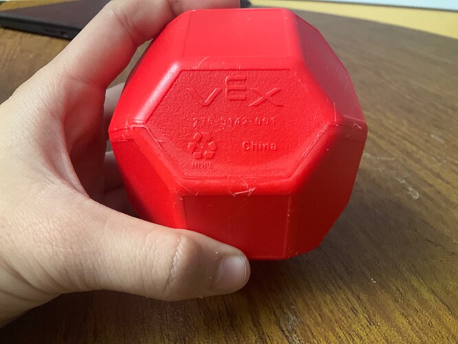

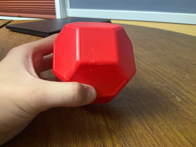

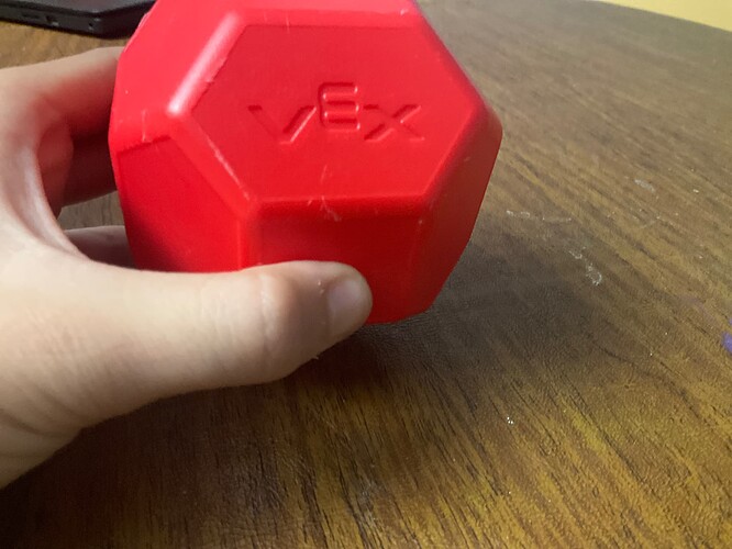

Cont.d For the games OctoBalls, they get scratched easily, because it’s made of that recycled milk bottle material. I really don’t like it in my opinion. I literally just finished the hero bot at home, and this is what it looks like

You’re correct that the game objects are made from HDPE, a material commonly used in the manufacturing of Milk Bottles, and other similar bottles for liquids.
This is for good reason!
Many of the hollow, symmetrically shaped objects from the past few years have been made from this material because it is one of the preferential materials used in Blow Molding.
Blow Molding is one of our preferred methods for manufacturing game pieces, especially when we put a lot of them on the field. Blow Molding is significantly cheaper than injection molding, especially in quantity, and is faster in many cases too. The wall thickness of the blocks is significantly thicker than that of a milk bottle, so they will not collapse on themselves nearly as easily as a milk bottle, and the geometric shape of the object lends some help in ensuring a strong object.
The competition has grown so large that we are making over 500,000 Blocks this year – if these had to be injection molded, that increased cost would have HAD to be handed down to the customer, making the kit significantly more expensive than it already is. We also would have been much more strapped for budget elsewhere in the kit, and may not have been able to commit as much towards the other elements on the field. Its likely the game would have suffered as a result of that.
While the HDPE is soft, and may be prone to scratches throughout the year, it is an incredibly DURABLE material. It’s very recyclable, and (as it’s used in food service) is widely considered a VERY safe material.
And even if one is damaged beyond repair, we included (6x) extras of each color in the kit!

Your right, but, I know you said this in the game reveal that since they are “octiballs”, the rickishay (I am terrible at spelling) will be different each time. However, what if the octoballs get “too scratched” and causes even more inconsistency as the tournament progresses? That’s my main question. What if the balls became too scratched, practically “sanded down “ on the seams, where you made them using the mold that you said earlier, and bounces around in the intake of the 2024-26 HeroBot, or doesn’t get aligned on the corners of the “Octoballs”, and therefore, the it bounces out of the intake to the left or right, instead of the tube, and damages the intake.

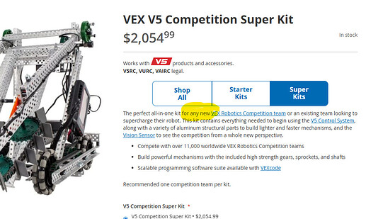

Here’s some of the problem, in the product description (my highlight):
“any new team” should NOT be in this product description, because we expect a new team to build the “herobot” trainer. It’s only on the V5 build pages that you see that a “competition starter kit” is needed for each season’s build.

This is feedback we have received before –
Hopefully it’s something we can better integrate into the next generation of kits, whenever those become real things!
