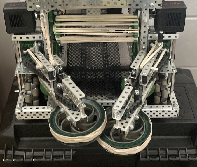

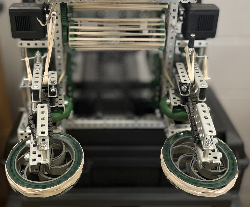

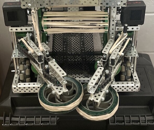

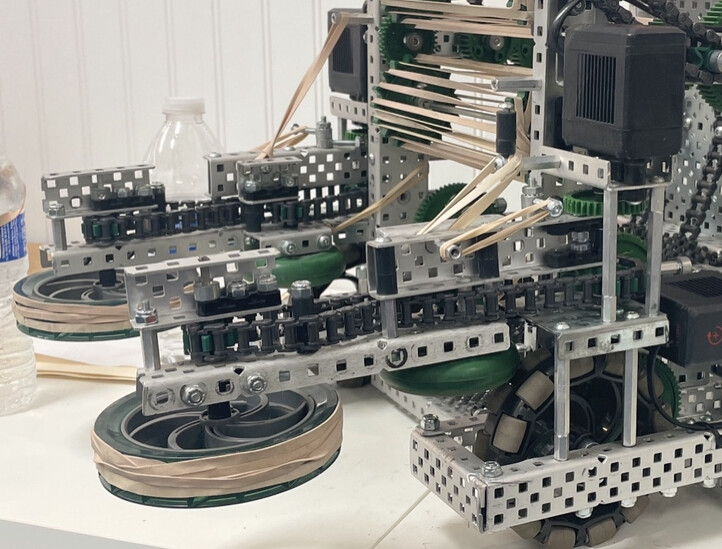

In the intakes, the mechanism allows intakes to rotate outwards and increase its angle, although it sacrifices the ability to outtake. The intake motor is on the axis of rotation of the intake arm, which powers a gear. this gear has a ratchet flap on the intake arm pressuring on it, and it’s configured such that it simply intakes when the motor spins one direction, but when it spins the opposite direction, the ratchet flaps placed locks in, and spins the entire arm outwards, widening the angle of the intakes. We used 36 tooth flaps as the gear and for the flap, made it with a cyan screw with 1 spacer and a keps nut (the gif is outdated sorry) on a collar, which is secured on a long screw at the intake arm’s c channel with another collar+ long screw being pulled by a rubberband. we’ve tested a lot of combinations and found this to work the best, although it can also work well enough with the 6 tooth sprocket with different flap configurations. This is particularly useful when intaking multiple balls on the field at once or getting the intakes out of the way to decrease interference with field elements, though the downside is that it can’t outtake, and a strong rubberband suspension on the intakes can cause the motor to overheat, which may be solved using a torque motor (but we haven’t tested this out).

So far there really hasn’t been any noticeable frictional losses when intaking, especially since the flap only needs to apply a little bit of pressure to work (about 1 rubber band worth), and even less when you use the gear instead of a sprocket
How is it that your intake arms rotate inward but also starts intaking after?
Basically, because it is easier for the arm of the ratchet creates more pressure on the gear, so that it is easier for the arm of the intake to swing out than to spin the gear. Once the intake hits its stop though, the ratchet spins the gear instead.

On the intake, there is a ratchet gear that it coaxial with the motor and it’s shaft. The intake pod is placed below it, and there is a ratchet tooth connected to the intake. The ratchet tooth is rubber banded so that it remain in contact with the ratchet gear. The intake is not connected to the shaft, that is, it free to spin back and forth without the ratchet. The sprockets and chain that power the intake are also coaxial with the motor and it’s shaft.
Intaking & Actuation:
When the intakes spin counter-clockwise (“intakes”), the ratchet gear is actively pushing the ratchet tooth away from itself. But the rubber bands are pushing the tooth into the gear. This the typical clicking sound you will hear. But the magic happens when the intakes spin clockwise. The ratchet gear is now actively pushing the ratchet tooth into itself, and the ratchet assembly forms a temporary lock bar. This is what allows the intakes to actuate. The intake hard stop is what will allow the intake to take again after actuation. Some teams will add a gear ratio to their intakes to have more control over the actuation.

Our intakes started the match folded inwards.
Upon actuation, a simple mechanical lock folded into place. This is what allowed the intakes to intake without having to actuate. Now they have become flipped out, and ready to intake.

My understanding of your design is that when the motors spin outwards (that is, as if they were going to outtake), they engage the pawl and the arms fold outwards into place (and then are locked there). When the intakes spin inwards, the pawl slips over and the intake wheels spin intended. Am I getting this right?
In the GIF that OP provided, it seems like they not only can fold the intake arms outwards, but can also fold them back in (until hitting a hard stop at which point the intake wheels will spin). This second part is what I’m confused about and I believe that is distinct from what you described. (I watched their video and confirmed that their intakes can fold inward as well, though whether it’s by the same mechanism I’m unsure). Maybe it is just a case of it being easier to fold the arms inward until the hard stop is hit—though I wouldn’t know as someone suggested.
This isn’t quite correct- they aren’t locked there. They should hit a stop, and the pressure of the ratchet will hold them there.
Basically, if you built your ratchet correctly, the motor should find it easier to pull the intakes back inwards than to spin the wheel, as it would be fighting against the ratchet to do that. Once it hits the stop, it becomes easier to push the ratchet arm back and spin the gear than to push through the stop.
