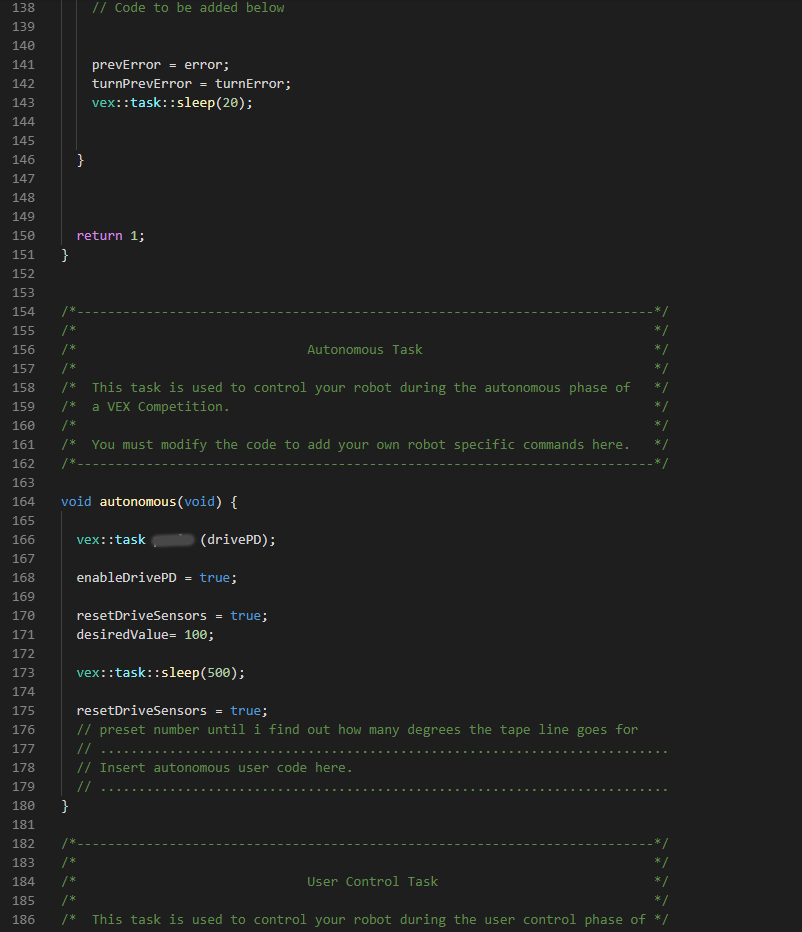

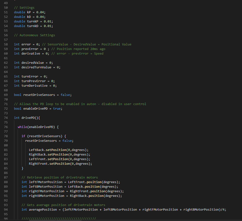

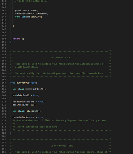

I have been following this youtube tutorial in order to make a PID loop. I have taken out the Integral as I am using this in my drivetrain and don’t want it to oscillate as one of my teammates advised.
I finished following the tutorial, but I find that my PD loop drives straight forever. Currently, I have the “desiredValue” set to 100, assuming degrees. What did I do wrong?

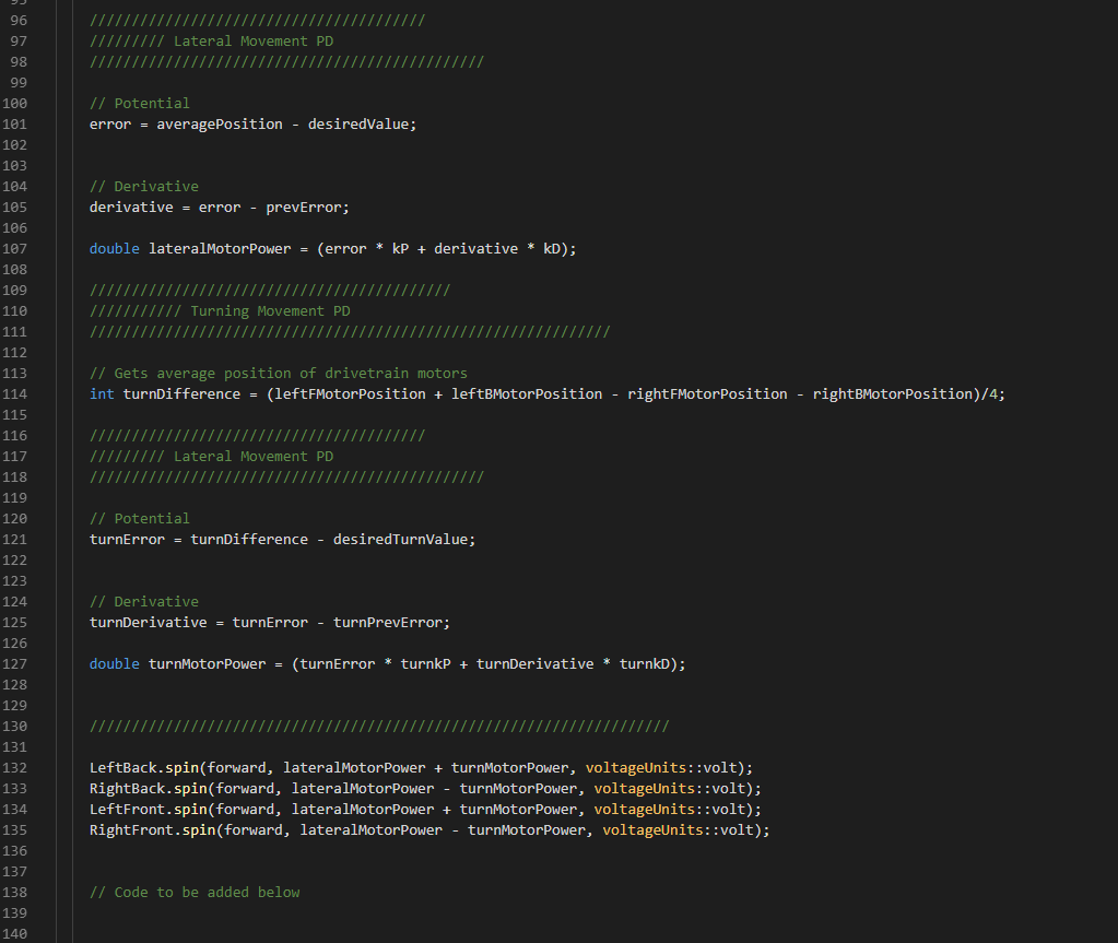

I am assuming that you are using Conner’s tutorial on VEX PID. I think your problem is that you copied it straight, but forgot to read his comment after.
" Fair Warning: I am unsure if I have the positive and negative motor values correct, as this is all done on the top of my head. So If the robot is continuing to go even after the lateral position is reached, change
error = averagePosition - desiredValue;
to
error = desiredValue - averagePosition;
If the robot continues to go even after the turning desired is reached, change
turnError = turnDifference - desiredTurnValue;
to
turnError = desiredTurnValue - turnDifference;
Helpful information:
If you need any further clarification, respond below and I can answer :slight_smile:"

Thanks! This works - sort of… Now, the code carries out the actions I tell it to, but after wards, seems to have a strange movement, basically twitching back and forth forever until I stop the program. I have a video demonstrating this.
In the code, the only action I have set is desiredTurnValue = 720;
What you’re seeing is that your code is oscillating around the endpoint. Because you have nothing to tell it that you’re close enough, it’s going to continually try to reach the endpoint, but it can’t quiiiiiite get there, as your Kp and or Kd values are causing steps large enough to drive it one way past the endpoint, so it overshoots, and tries to move back, which undershoots.
And that is PID oscillation.
My advice, if it’s within a certain amount of your target, don’t take any motor action.
Dang, even without the Integral it was just oscilliating the whole time? In that case, couldn’t I just lower the kP/kD variables until it stops doing so? I’m not sure about what you mean in your last statement.
Technicall? Yes. Effectively? No, not really. You have to keep in mind that there are multiple types of PID loops; some are designed to keep an always-moving system held to a some target. Others are finite systems, where they end at a certain point.
In this case, you have a finite system, in that you get to a desired target and you are basically done (until the next target).
In this case, you need to find a sweet spot where your motor position is within X degrees (say 2 or 3), and if it’s within that range of the target, tell the motors to stop, and then when your target moves again to be more than 2 or 3 motor encoder degrees, the system starts up again.
