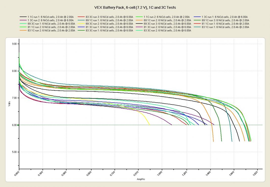

Dean, et al,
A couple of years ago, my VEX students thought that they had a bunch of dead batteries. I gathered some data (see attached) and made a PowerPoint presentation for them which, if refined, could cure insomnia…
At any rate, you might find the data interesting. My conclusions were:
[INDENT]Most of the data “scatter” is likely attributable to temperature variations.
All of the batteries underperformed from their rated specifications. However, they did so in such a uniform way as to suggest that the rated specifications might have been reported in error.
While a couple of the batteries appeared to benefit from exercise and/or reconditioning, all batteries were considered acceptable for use in a VEX competition.[/INDENT]
I used a CBA II battery analyzer from West Mountain Radio to perform these tests…
Enjoy…
Mike
Postscript: Most of these batteries had at least 3 years of “heavy” use and abuse at the time of the analysis…

Yep, I think all batteries are sensitive to temperature to some degree (actually, so are electronics, but digital mostly hides the issue). I’ve noticed some thermal effects with my battery tests too.
Age and abuse will derate the capacity somewhat (I’ve seen specs that indicate you should derate to 80% after 1000 cycles).
Also, most NiCd and NiMH batteries are rated at 0.2C, and the available capacity decreases as the load increases. This is at least partly due to internal resistance, which is particularly visible in the 3C runs on your graph. Their voltage is depressed across the entire run, and crossed the cutoff voltage before the curve even gets to the steep part. I suspect you could have gotten several hundred mAh more from them if you continue the discharge from that point with a lower load.

Do you intend to post this data to the Wiki? It might be nice to test some new batteries also. I can get you some to test while your test fixture is up and running.
Yep - I’ve been generating the graphs and I’ll be posting them in the next day or so. Excel was simply choking on the volume of data (10K samples for some of the runs), so I’ve been teaching myself R and I’m finally happy with the results.
That would be outstanding! Of course, all the NiMH batteries I tested were brand new, but all my NiCds are years old. If you still have stock of any of the discontinued 7.2V NiCd packs, I would appreciate a pair of them so I can do “New NiMH -vs- New NiCd” comparisons.
Thanks!
  • Dean
This writeup has been posted to the wiki for a while now, but I just went back through and cleaned things up a bit. Have a look here if you are interested.
Also, I added some graphs to the wiki pages for the three 7.2V batteries.
