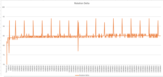

I supposed what I’m curious about is that jump to 93 counts in the 50 ms period every 1.4 to 1.45 seconds. I’m seeing pretty consistent raw counts of 84 to 85 every 50ms, but then it jumps up by 10% or more in that same period.
I could run that loop for 5 minutes and you’d see that 10% spike in encoder counts hitting consistently, and the motor is running with no load.
I expect to see a little variation in the counts, but not that big of a jump, and not at such a regular cadence.
If I graph the encoder counts, measured every 50ms, it looks like this:
That periodic jump is unexpected.
So the issue is that the motor is determining the 5mS communication rate where the brain has its own background processing timers. If for some reason the brain processing missed the data from one message you would see a jump, the following sample would probably be less. That’s what I assume you are seeing.

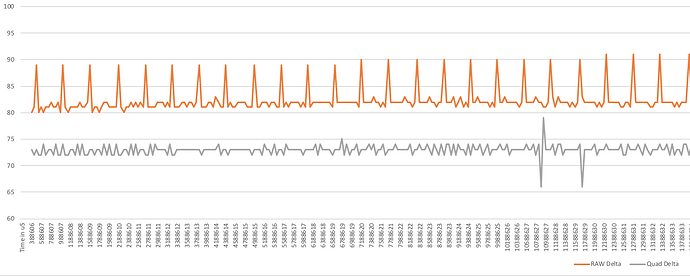

One last little experiment. I connected a Quad Encoder to the shaft and measured the output of both the V5 and Quad encoders at the same time.
After 21 full rotations of the shaft, both encoder counts (converted) were exactly the same. The Quad encoder didn’t have that periodic “catchup” seen on the V5 encoders.
(V5 on top, Quad on bottom)
I’m wondering if there’s a loop frequency that will minimize what I see on the V5? If I were trying to determine rotational velocity with the raw encoder counts, that jump would fool the algorithm (PID, or whatever) into thinking that it had sped up.

First, I’d try to sample both values first, then to print them to rule out (or limit) the case where one more update comes between the time capture and the rotation capture. But if that was the case (or a general jitter that would cause your sample point to fall just before vs. just after another update), you’d see an about-equal-sized drop on the next sample and I don’t see that in your charts.
So my best guess is that the motor clock is running a little faster. AFAIK the motor MCU has no precise time reference (crystal oscillator) and runs on (at best well calibrated) RC oscillator, with the frequency easily off by 1% or more. As the motor samples its internal count every 5ms (of it’s internal time) and send it to the brain, each such sample is about 8 ticks bigger than the previous. The brain ditifully receives all the updates and keeps the last known value (with a granularity of 5ms worth of rotation, or about 8 ticks). Your program queries this value every 50ms, that is, roughly every 10 updates from the motor, but if the motor clock is 1% faster, it would sneak in 11 updates into about every 100th iteration of your program (5s).
What you see in those 5 seconds (or 1.4s in your case for about 3% motor clock drift) is that your sample point gradually drifts across the 5ms window of the motor’s sample point, then you cross the boundary (see one more sample) and your 5ms drift window resets.
If you were sampling every 5ms, you’d see delta values like 8,8,9,8,8,8,9,8,8,16,8,8,9,8,…
If you were sampling at 1ms (assuming the brain would let you), your deltas would be like:
0,0,0,8,0,0,0,0,8,0,0,0,0,8,0,0,0,8,0,0,0,0,8,0,0,0,0,8
(i.e. 4 zeros most of the time, but only 3 zeros when your clock base windows cross)
