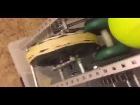

Here is our attempt of addressing these problems by building an extremely low-friction flywheel prototype:
Earlier vamfun presented a convincing argument that a single flywheel with large moment of inertia, running at twice the speed of the dual flywheels, is an optimal solution. That is, if you can successfully manage the friction.
The purpose of this video is to show that two 393 motors provide enough power for a single flywheel launcher. There are two turbo motors driving flywheel with 19.2:1 external (46:1 total) gear ratio. Not only there is enough power to reach the high goal, but flywheel rotates way too fast and keeps overshooting. We will fix that later.
I haven’t done precise measurements, but from the crude video analysis it looks like if you feed the balls at the right speed you could consistently hit target while shooting 4 balls in about 2 seconds. If you feed balls as fast as you can - it will launch four balls in just over a second with the first three overshooting, and the last one falling slightly below the target. Clearly at that speed flywheel has enough kinetic energy stored to give the first three balls more than enough speed. Obviously, for this design to be practical the feed rate needs to be program-controlled like 323Z does.
Single flywheel concept also fits nicely with reducing robot’s weight, size, and the number of the moving parts. The last is especially important, because it will let you reduce the number of axles.
Technik jr started building our first prototype with 21:1 total ratio driven by two force motors. It could launch balls only a few feet away. It would not even spin up with one force motor. Getting down to one force motor was relatively easy with just better build procedures, but moving further was much harder.
Power loss at each axle is proportional to (torque due to friction) * (angular velocity). Therefore even 0.5 in-lbs in resistance at the flywheel bearings would amplify 21 times to 10.5 in-lbs around the motor axle ( out of maximum available ~15 in-lbs stall torque). However, you want to run motors at only ~10% of the max load for the best efficiency, spinning at about ~85% of their idle speed (see the graph in the post below).
According to our estimates for a single 5" flywheel that would require ~ 30:1 total gearing. Since each axle introduces friction, you want to reduce total number of axles. Both speed and turbo motors could be used with just three axles and require ~19:1 (speed) and 12.5:1 (turbo) external gear ratio. I think turbo is a better choice because smaller torques will flow through the system.
So the next task was to actually reduce the friction so much that the launcher could be spun up with a single speed and, eventually, turbo motor. Technik jr and teammates have developed better alignment procedures and it let us, at least, start with a single speed motor, but launching balls or starting up with a single turbo motor was still unreachable. There was just too much friction between square axle and the bearings, which would only increase when flywheel would try to compress the ball.
So we did two things: first we introduced a pre-boost stage to pre-compress the balls at the slower speed, when more torque is available, and second, and more important, we figured out how to build a better bearing. I still cannot reveal the secret of how team did it, but I could give you a hint that they found an almost a perfect VRC-legal part for this mission, broke 1/8, and stripped 13/64 drill bit while perfecting the implementation :slight_smile:

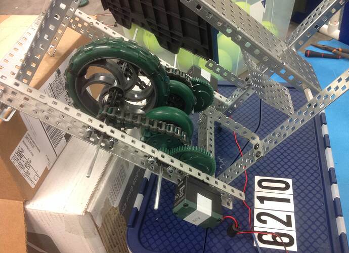

Here is our flywheel after we redesigned it today. We got it shooting at around 80% accuracy with a 13:1 and 39:1 gear ratio but it stalled after about 7 or 8 shots. After this we reduced the ratios to 13:1 and 26:1 and it didn’t stall but the balls were landing a foot below the lip of the goal when positioned inside the loading zone. My best guess is that the optimum gear ratios are somewhere a little above 10:1 for the first wheel and somewhere around 30:1 for the second wheel. I am hoping to test out some of the following ratios next week: 13:1 and 32.5:1, 11.2 and 28:1, and 13:1 and 26:1; that last one being built slightly different (positioned vertically with a curved back, sort of like 323z’s).
My best guess is that your compression is not working well enough. We put a C-channel across the top of our entire system and 30:1 seems to be the best gear ratio for that design (although I am not sure whether or not that compression technique hinders our rate of fire).
