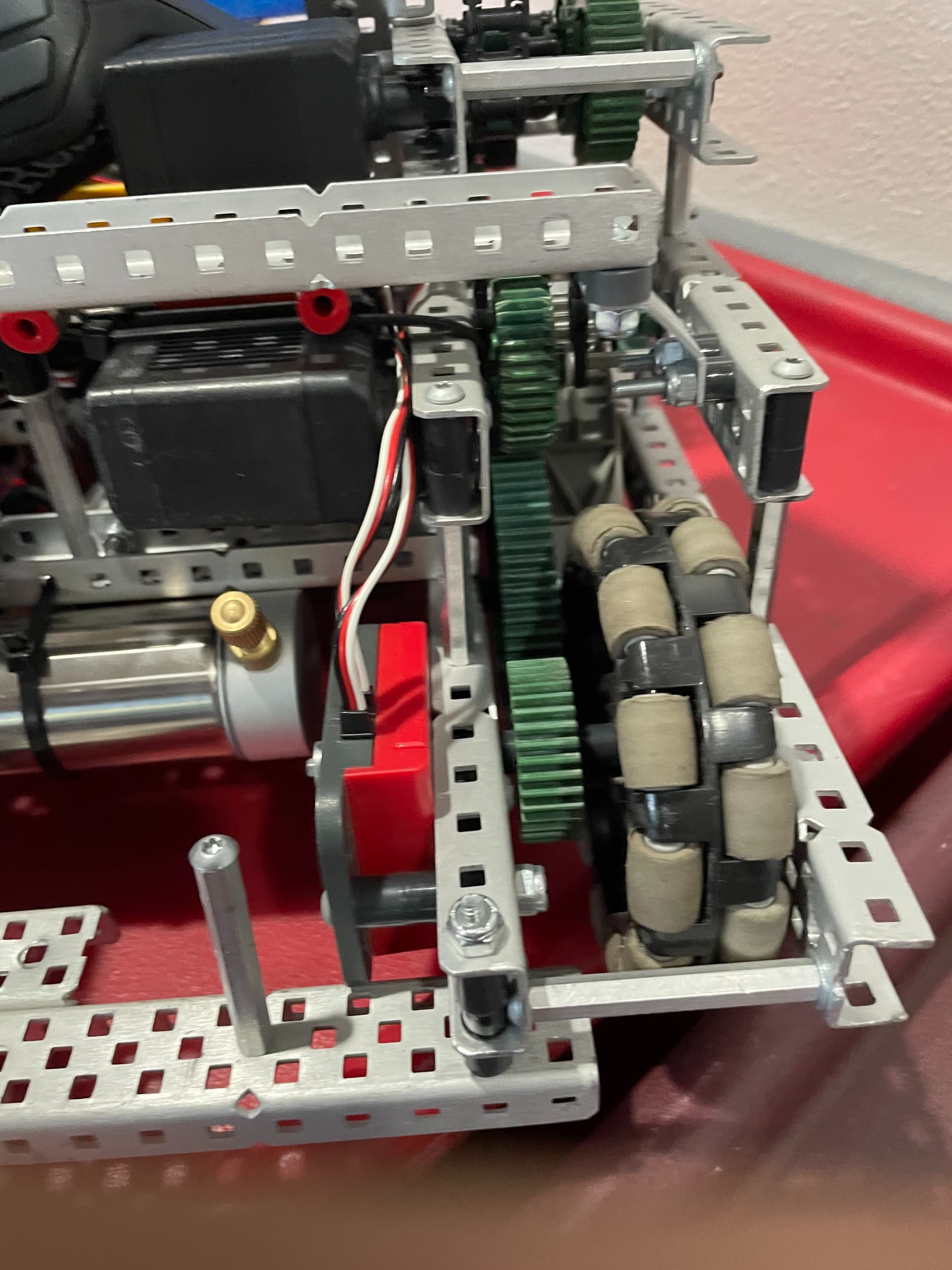

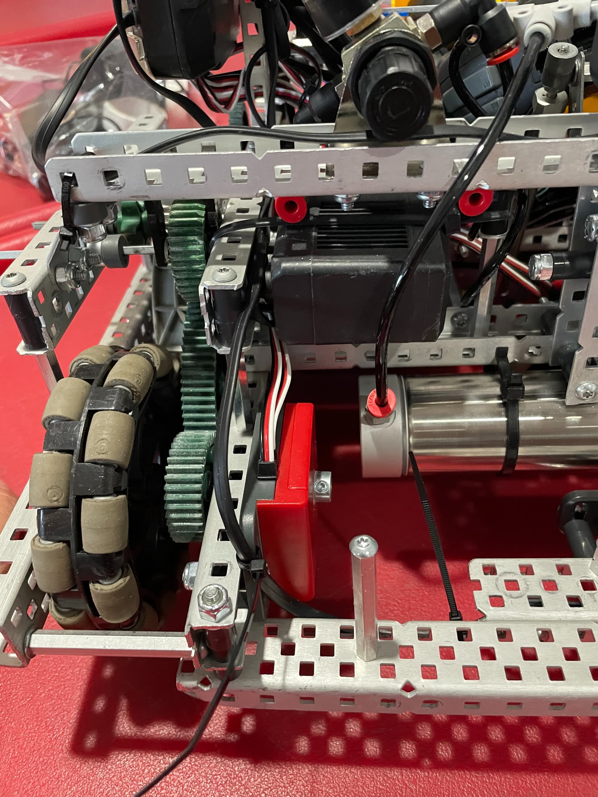

yet when this portion runs, the drivetrain drives straight ahead instead of turning 90 degrees like I expected. I do not believe it is an encoder placement issue, and here’s a pictures of our encoder setup:
The encoders are directly attached to the wheels (for now) and are facing the same way, and they are attached to the brain correctly (top 3-wire first, then bottom 3-wire).
So I am wondering, what is the issue? If anybody could give any useful tips that would be amazing. :pray: :pray: :pray:

ah odometry() was originally named getheading(), and I forgot to change while transcribing to vex forums. The thread is being called though, thanks for the heads-up.
Will implement the windup fix as well as the negative error ASAP.
Thank you!
