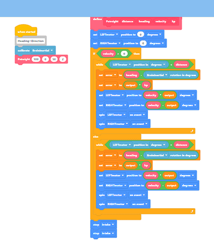

Hi guys, hope you’re well Lately i’ve been strugling with autonomous so I used caution tape one but instead of using the gyroscope, I used the brain inertial but for no reason when I run the program, the robot starts to drift Does any of you have a solution? Thank you for your understanding.
It may be the brain inertial or it may potentially be the fact that the KP is pretty low which leads to drifting.
Legacy gyro and the brain inertial sensor work in opposite directions, that is, legacy gyro turning counter-clockwise will increase rotation value, the brain’s internal IMU will increase rotation value when turning clockwise.
For blocks one possible fix is to multiply the rotation value by (-1) to be able to use the same code. Text would allow more options.

Yes I know but it should 'nt be a probleme for going straight bc for going straight the heading is 0
But if it could stick to exactly zero, you wouldn’t need PID.
Because the inertial is opposite of the gyro, you have to fix the math one way or another if you want to use it. If you don’t fix the math, the robot is not going to drive like you want it to.

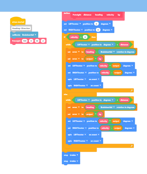

yes i solved the probleme of drifting currently the new problem is pid isnt correcting the movement of the robot

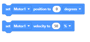

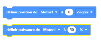

My French is a little rusty but I think you need to change “définir position” to “définir puissance” since you want to adjust the velocity settings of the motors. This should be done for both cases: forward and reverse.

Looking at your second screenshot in comparison to the first, it looks like you’ve changed the error calculation to a ‘+’ instead of a ‘-’, and in combination with multiplying by -1, you’ve changed what the math should be doing back to being opposite of what it should be relative to the original CTR Drive Straight code.
Also, your Kp value of 1.5 could be too strong and cause the bot to wobble. You could try making it something like 0.5 or 0.25 and see what difference that makes.
Did you fix your code? The code you posted a bit over a week ago appears to have errors. It would not work with either the older Gen 1 gyro or the G 2 internal sensor.

Sorry, I misread the date. I’m referring to the code posted on 2/20. Did you change the block “définir position” to read “définir puissance” ? From VEXcode IQ:
French
Screenshot 2024-02-25 191113
English:
Screenshot 2024-02-25 191128
