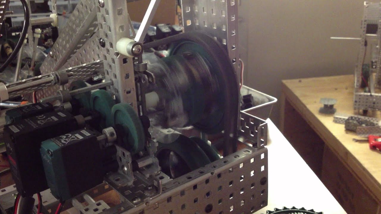

Here is a vid of a vex planetary transmission that doesn’t appear to have a design flaw. I know it functions off locking certian parts, but I don’t actually know if its just a shifter, a PTO or a combination of both. Prob both.
That robot didnt have a planetary transmission. You can tell from the thumbnail with a motor directly attached to the middle wheels.
And again the first vid sam sent had a non chained mecanum drive.
