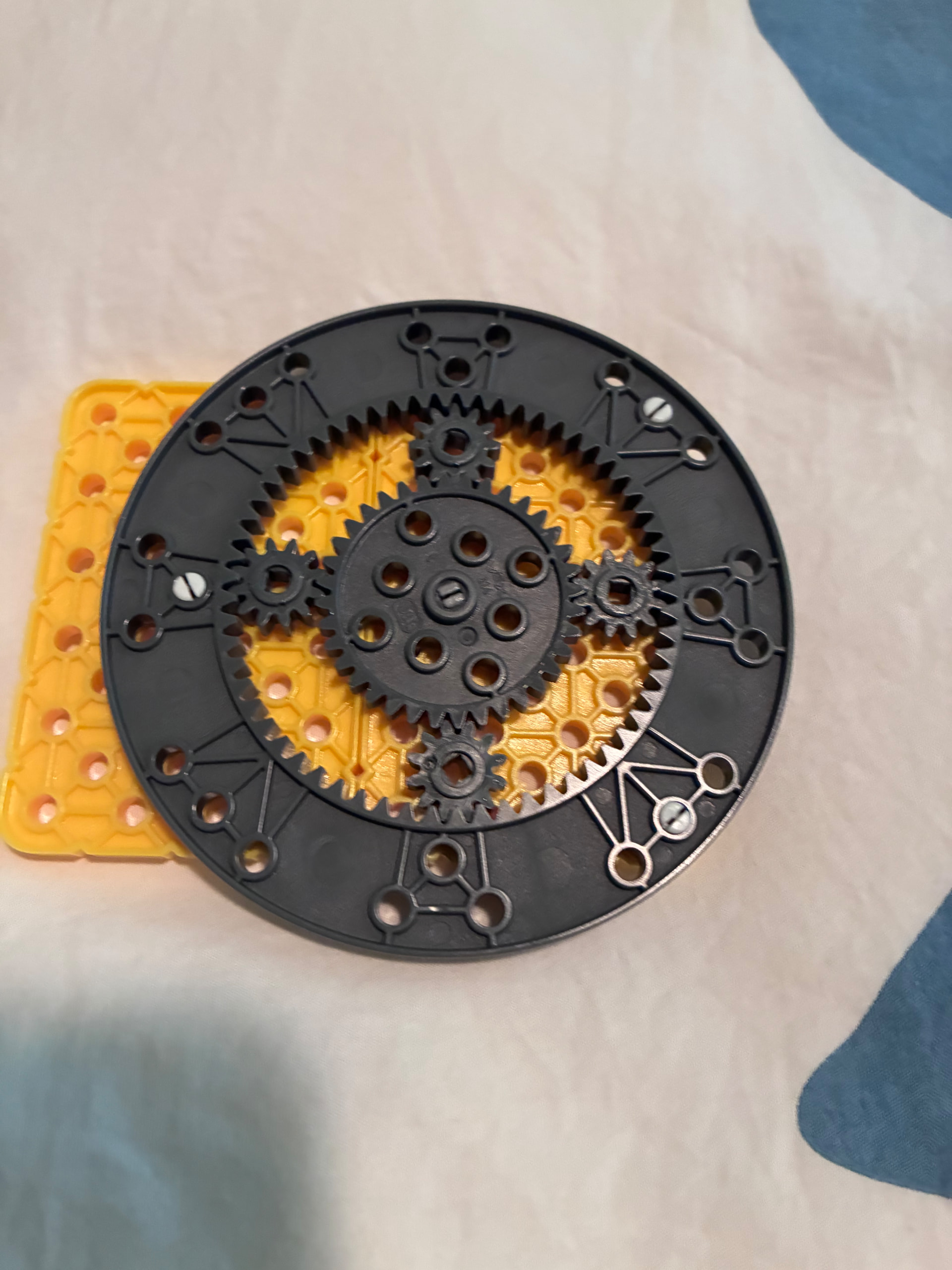

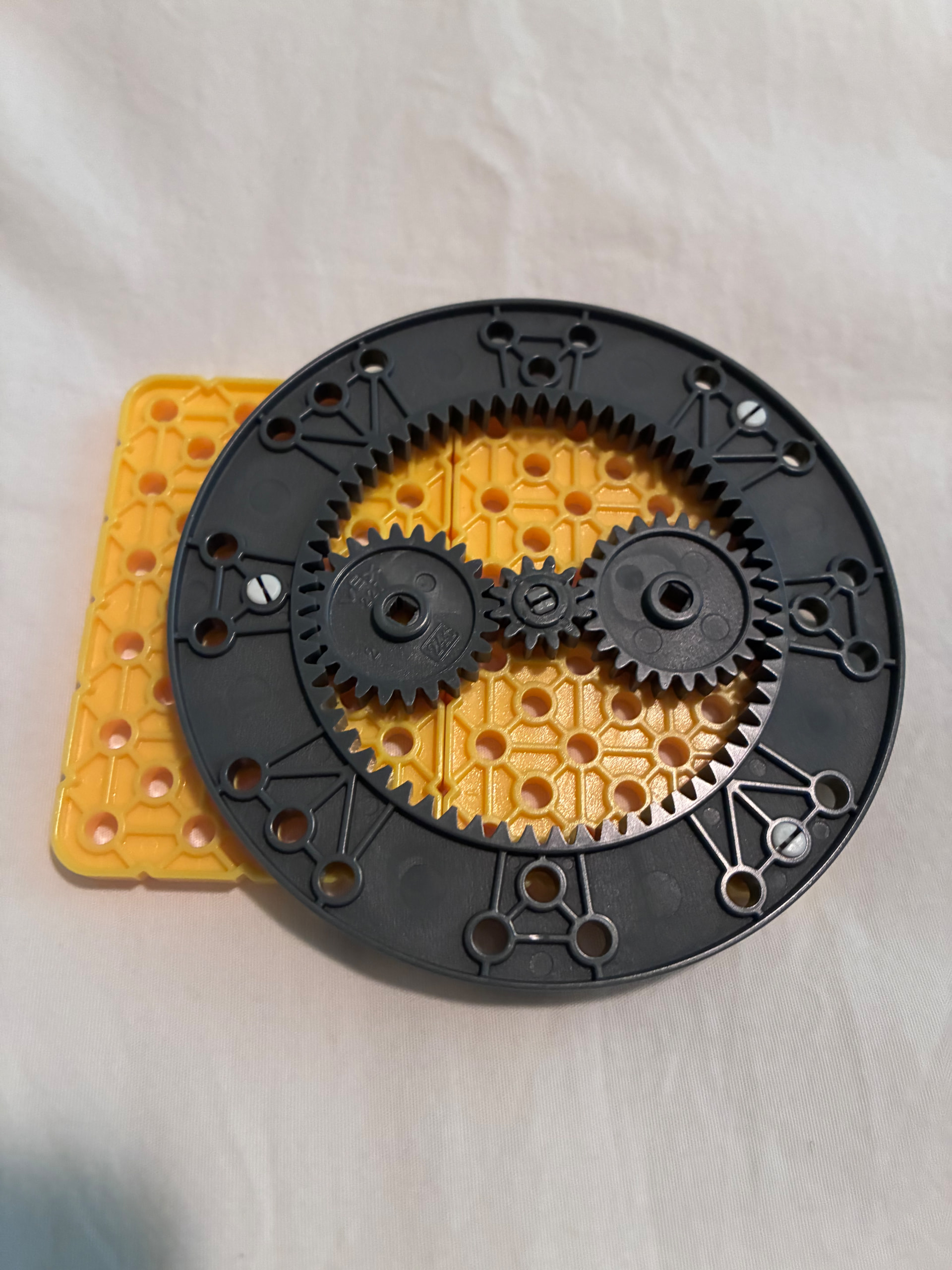

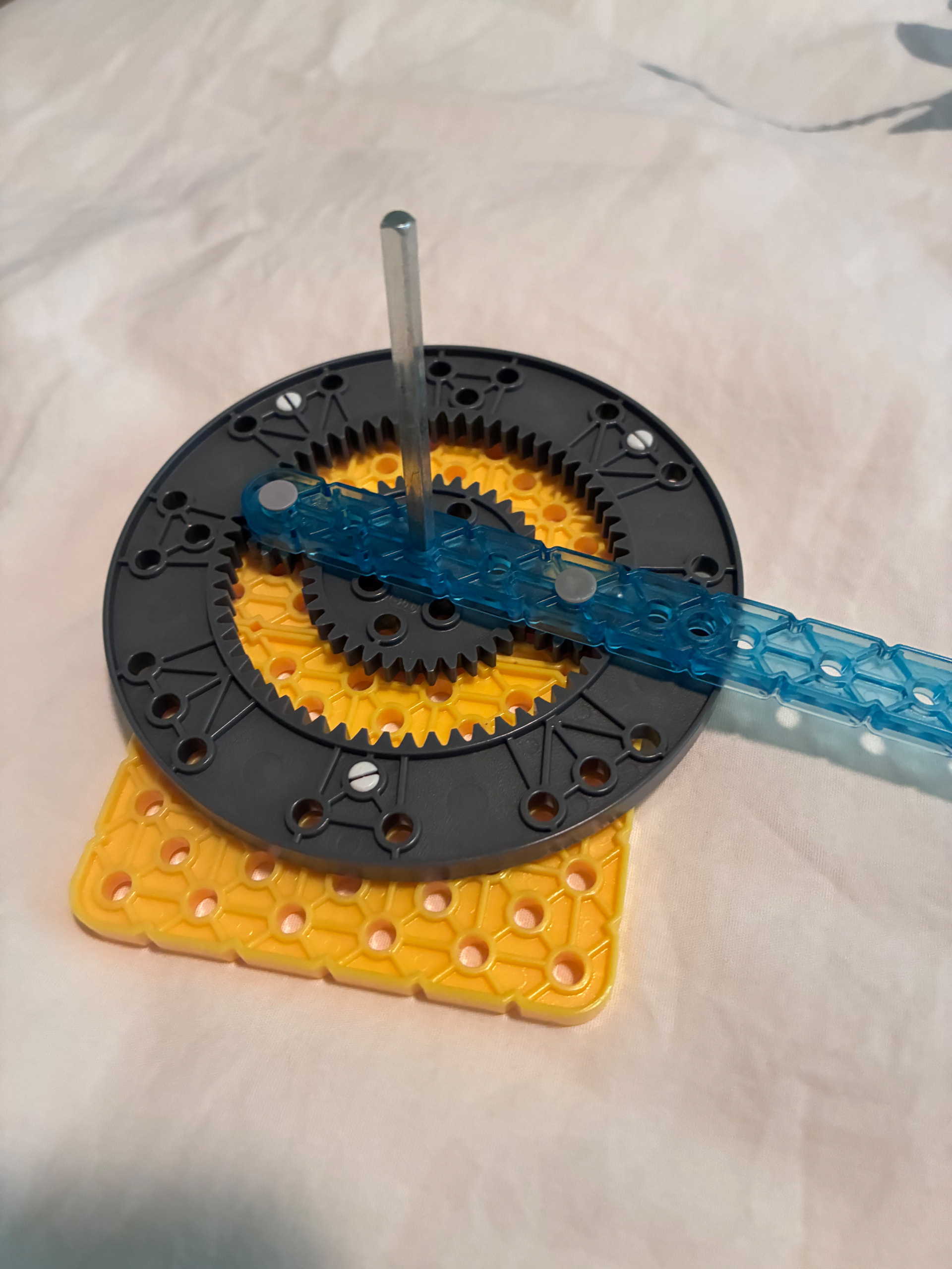

@Foster I know you have had an interest in planetary gears. I recently obtained the 60t ring gear from a Hexbug “Orbit” set and Planetary Gear Simulator suggested a setup with either 36t sun and 12t planets OR 12t sun with 24t planets would work. Indeed they do. Unfortunately is not possible to use more than two planets and have it fit the geometry of a carrier (for the 36t sun version). The 12t sun with 24t planets gives 6:1 reduction. The 36t sun gives a somewhat odd 8/3 reduction. Regardless, my son keeps wanting a way to incorporate planetary gearing into his bot. Will see if his team can do it this season.
