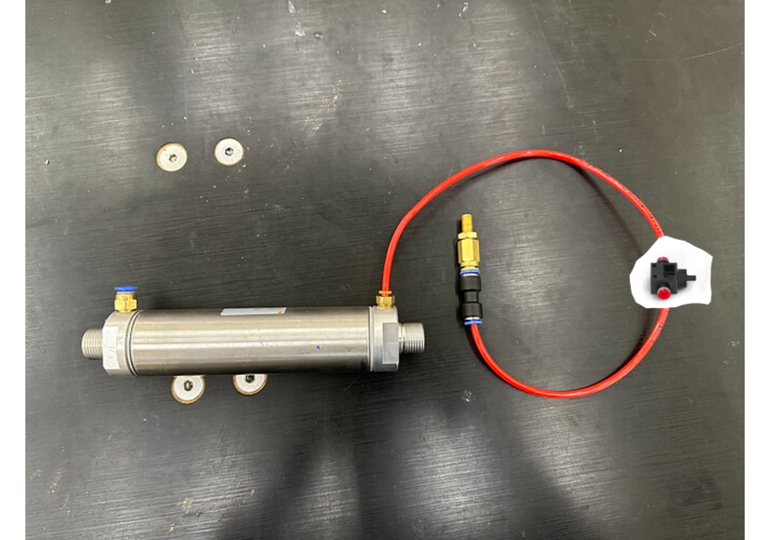

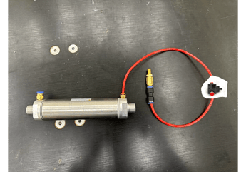

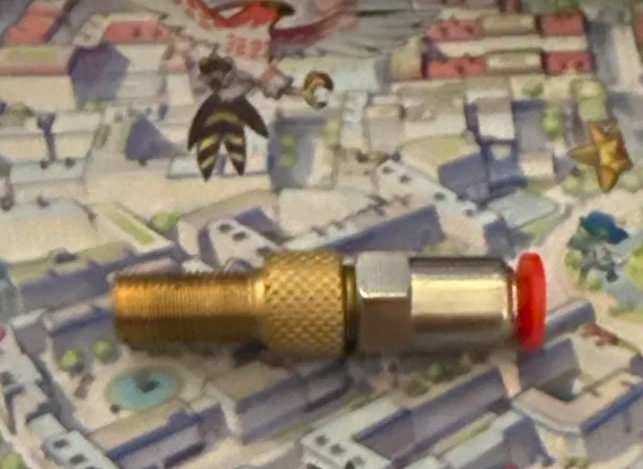

For the issue of losing PSI when disconnecting the compressor, I reccomend having a system like the one pictured below using the tire valve attached to a line out the end using the plug from the small red pressure gauge and attach that to the black valve for filling the air tank.
*if at first the valve is letting out air when closed flip the direction indicated by the arrow.

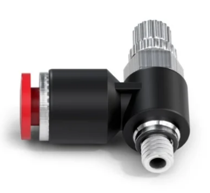

You could also do this with more modern parts in a smaller settings. All you need is a schrader valve, female fitting, and air flow valve.
Just attach the valve to the tank and use a pneumatic tube to attach between the valve and female fitting.
My robots this year have used it, and it’s incredibly useful (although the air flow valve is a bit slow on closing, but that’s fine usually)
