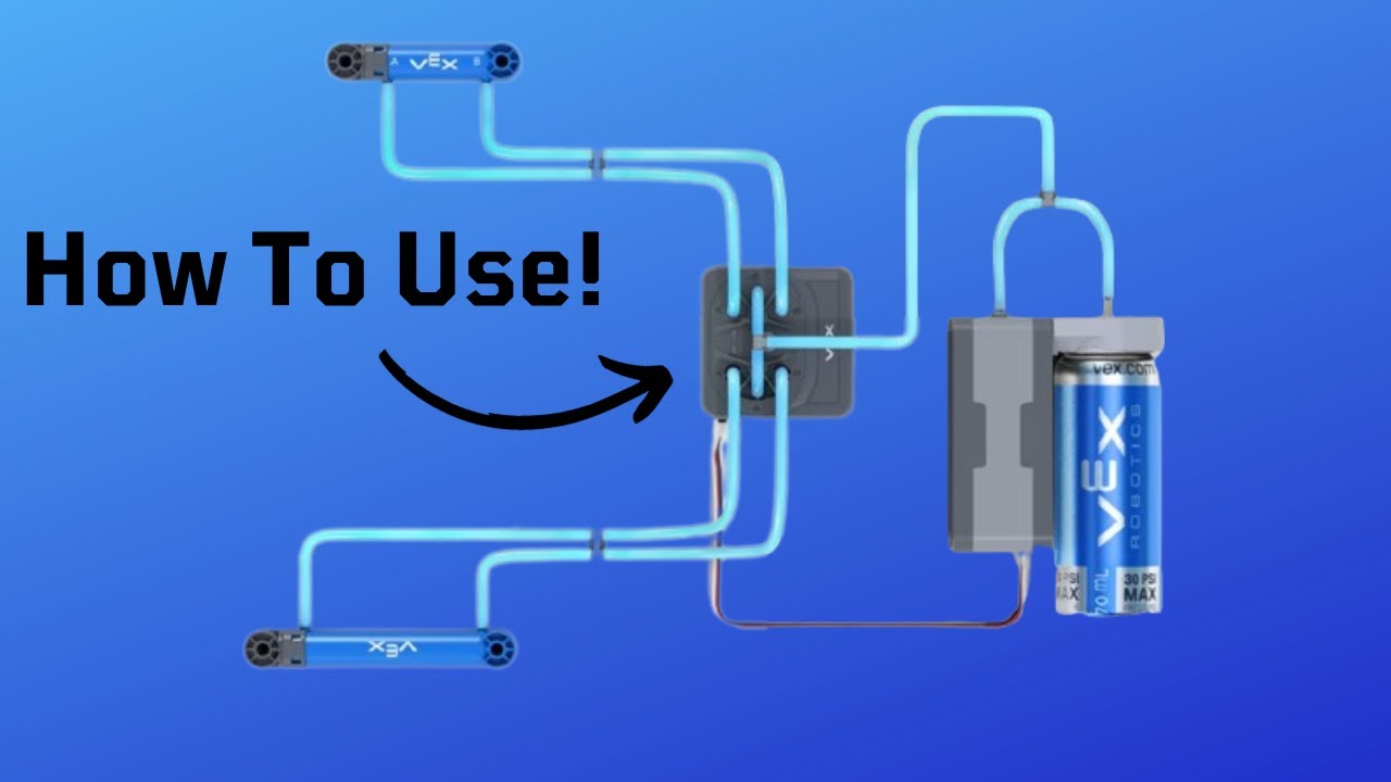

Hard to explain, but make sure:
When you put the tubing for the claws the tubing goes like:
A of cylinder 1 to A of cylinder 2 (add a t-fitting to merge to tubing and then connect the tube to the tank) B of c1 to B of c2. :sunny:
We accidently connected A to B and B to A being absolute beginners in pneumatics SO DON’T DO THAT
