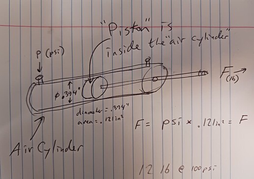

When using a single solenoid for multiple pistons do you get the same amount of power you would when using a solenoid for each individual piston
Perhaps this sketch of an air cylinder will help a bit in your terminology, the piston is a small component inside an air cylinder:
To answer your question, if you add tee fittings after your solenoid valve to distribute the air between multiple air cylinders, each air cylinder will receive equal pressure, and thus develop equal force. At the small scale of these 10mm cylinders, you won’t see any degradation in the actuation speed. In industrial settings, the designers will consider air volumes and size solenoids and piping appropriately, an option you don’t have (or need) with VEX-legal components.
