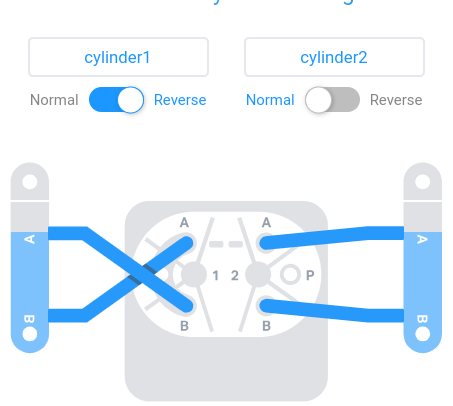

Do you mean whenever you turn it on? If you do, It may be a code issue. In this screenshot of vexcode:
you can see that cylinder1 is reversed and cylinder2 is normal. In your code, you may need to switch some of the cylinders in the code, or switch the physical pneumatic tubing. Can you please post the picture or tell me some more details to help me more? :slightly_smiling_face:
