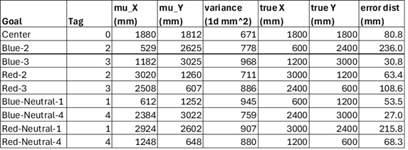

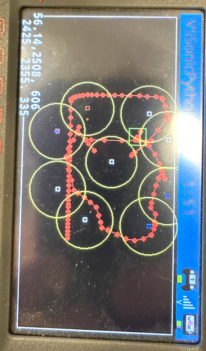

Here’s an initial attempt at doing the “forward” detection, meaning learning where the goals are using existing odom. In reality of course you want the opposite - knowing how to correct your odom based on fixed (or somewhat fixed) markers.
For this demo I’m using 1d Kalmans (Kalman Filter | Purdue SIGBots Wiki) in X and Y. Process noise is based on approximation of odom drift (~0.05mm / 10ms update) and measurement noise variance was set fairly high at 1m per 10Hz camera update.
The triangulation logic is fairly basic. For distance I use a mix of tag height (in pixels) and offset from bottom of image depending on low, middle or high goals. Relative heading is based on offset from center of image in X although this should really take camera mounting pitch into account. So improvements possible here.
Some challenges:
  • AI snapshot update rate: I haven’t been able to find a way to know when exactly a snapshot gets updated. Based on looking for changes in detected objects it seems to average at around 10Hz. Based on this I take snapshots at a higher rate looking for any detectable updates or timeout at 100ms and pass this on as a fresh detection. For filtering this is important or you’ll feed it with spurious accuracy
  • Spurious detection: You want a robust way of rejecting false positives
  • Re-used tags: All the faces on a goal use the same tag, so knowing which face you’re working with requires use of the inertial sensor and some math. However, I think limiting the number of tags used was necessary because of the previous point
I wanted to see how well this worked without specifically visiting each goal (ie getting a mix of glancing views and actual visits).
For coordinates I use North-East convention (X is North, Y is East, 0deg is North increasing clockwise). For the results 0,0 is far left of blue alliance wall (actually under perimeter).
The ones with the high (>100mm) error distances are where there was only a brief fly-by.
Color code:
  • Green Square: Current robot location
  • Red line and dots: robot trail
  • Blue Squares: Blue alliance goals
  • Red Squares: Red alliance goals (note one has a blue trail inside of it showing how the approximated center moved)
  • Yellow circles: Confidence (robot has been stationary for about a minute so these have all grown to maximum allowable for rendering anyway)
Results somewhat encouraging anyway for looking at the reverse process (odom drift correction).
