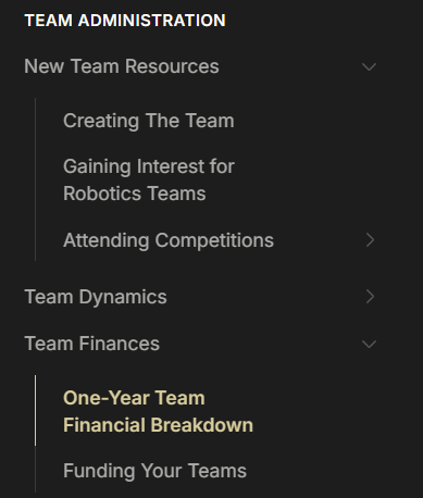

In terms of a breakdown of typical costs, the Purdue SigBots Wiki has an amazing article that covers a finances that a team had during their first year of VEX. That wiki in general is an amazing website for a new team, I’d highly recommend bookmarking it or saving it somewhere.
The entire Team Administration section on this website will be really useful to you.
