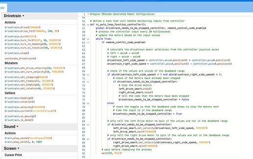

Just create a dummy Python project, hookup the controller to the drivetrain, and look at the generated code. I would not use this directly (auto generated code is not pretty), but it gives you an idea of how simple it is.
