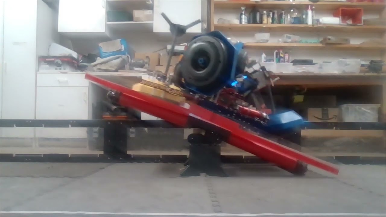

Problems with parking

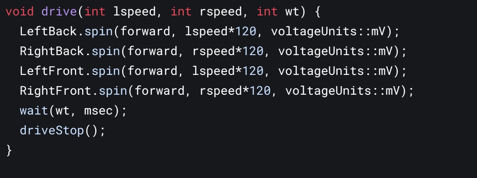

Yes, you should. Use percent of volts. You have to times millivolts by 120

Here is sample code
double l=Chesseburger1.Axis3.value()*1;
double p=Chesseburger1.Axis1.value()*1;
    l1.spin(directionType::fwd,(l + p),voltageUnits::mV);
    l2.spin(directionType::fwd,(l + p),voltageUnits::mV);
    l3.spin(directionType::fwd,(l + p),voltageUnits::mV);
    l4.spin(directionType::fwd,(l + p),voltageUnits::mV);
    r1.spin(directionType::fwd,(l + p),voltageUnits::mV);
    r3.spin(directionType::fwd,(l + p),voltageUnits::mV);
    r2.spin(directionType::fwd,(l + p),voltageUnits::mV);
    r4.spin(directionType::fwd,(l + p),voltageUnits::mV);
would this work?

You would need to multiply the values by 120
It still doesn’t work.
We changed the drive to 450 rpm and now it can park with six mogos
bruh, six mogos??? That is dope. Any videos?
I’ll post one.

My old robot had 6 motor 200rpm direct and it could park with 5 too.
