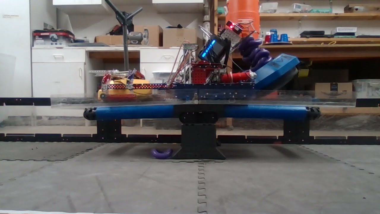

We have problems parking with 2 mogos. we simply stall out as if the drive train doesn’t have enough power. The bot is 17 lbs, and has 8 motor drive diirect 600 rpm with 2.75 wheels. the drive has low friction.
Please show us your code / photos of the drivechain

from my experience you shouldn’t be having issues. i’ve parked with two goals on 6m 600 being about 16 pounds? pics/vids would help a lot.
8m 600 should have more than enough torque to climb with 2 mogos. It’ll be good if you can provide some images of your robot. I am guessing that weight distribution might be the problem.
8 motor drive? Wow. You’ve accomplished my dreams. Take off as much of the robot as you can with as little screws as possible, like our lift system was held up by 4 standoffs, and we took it off once for testing. If you can’t then idk you’ll have to post a video.
here is my bot
You posted a video of your robot parking with two goals a few weeks ago. What changed since then?
It only parks when the motors ore completely cool. if I even move it around, it just stalls out. I suspect that it might be a motor problem, but I’m not sure.
Have you checked if your motors are over temp when you can’t park? It should say on the event log
The “motor problem” is that you are asking too much of them and they heat up to the point that they throttle their power to 75% then 50%. If they only do this after > 2 minutes, you can probably get away with it at worlds. Matches are relatively far apart. Students tend to loose track of time while practicing in my experience. Driving for 10 minutes is a whole different thing than driving for 2 – especially if you are doing something like parking practice.
