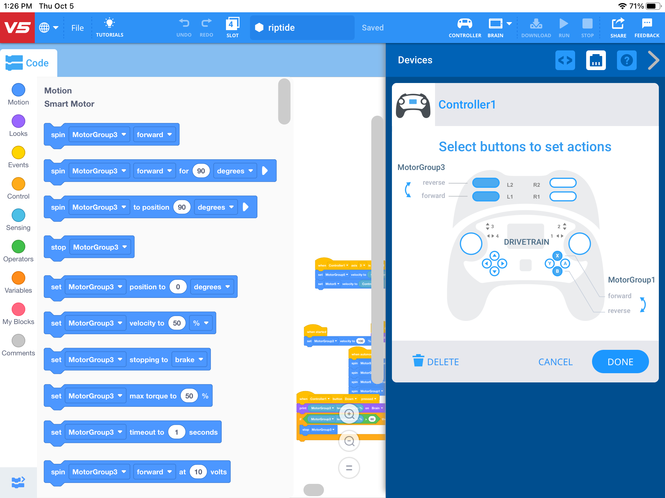

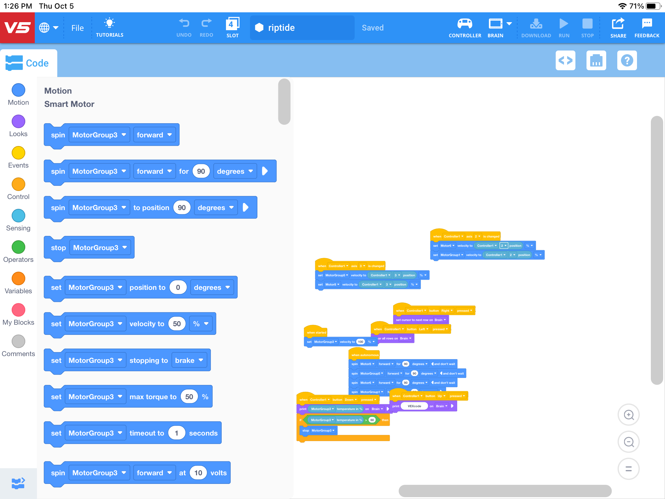

We are having trouble putting the program of the drive train on to the joysticks in the controller. We do not know how to please help.

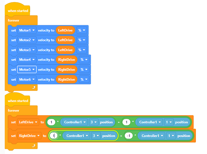

I had to remember how to code blocks to do this
This is just an example of an arcade 6m drive.
If you want more or less motors change the variables at the top.
If you want something other than the arcade figure out how to code yourself because arcade is superior.
