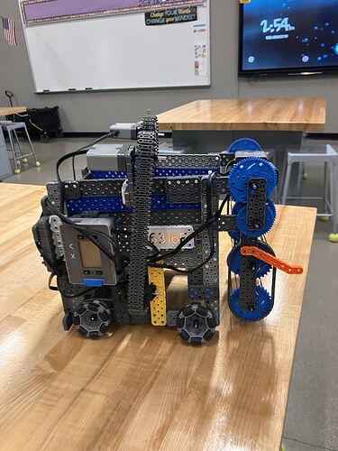

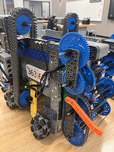

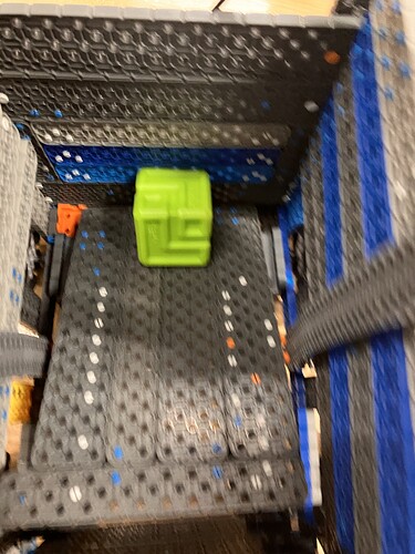

Thank you all for the responses- this helps for sure. Here are some photos of the setup for context
This an amazing robot! Our robot is similar but the lift is a bit smaller.
You could add pegs or something to make it where it can’t extend past a certain height. if your only getting greens you could also just code it to where it only goes into the collecting and scoring possession.
Our team added a bumper under the lift shelf (similar design).

(Shelf was pushing down on base and was breaking.
Now shelf motor stops at bottom.
We also added yellow bars at top for visual to driver.

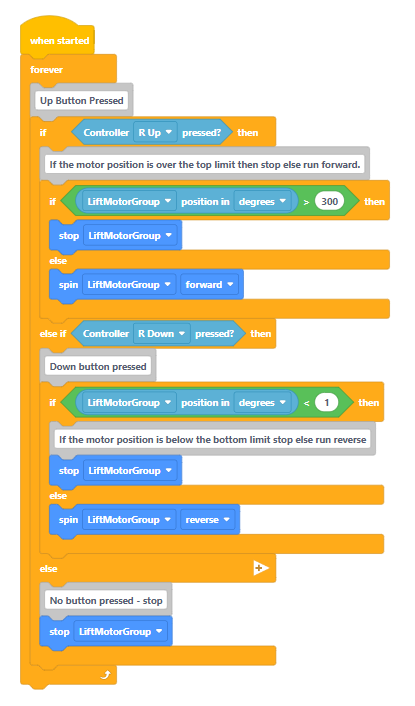

Here is one example of limits in block code. You will need adjust it to fit your needs.
