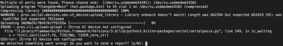

Since it is impossible to currently download a program through the controllers due to the bug in PROS CLI-3.2.0, I tried to download programs directly to the brain but am unable to do so. The issue that we are running into is that once the download begins it appears to crash.
The uploading just stays at zero and doesn’t time out and I am forced to disconnect or close the terminal. What is unique is that there are multiple different USB ports that show up. Two ending in 14101 and one ending with 14103. I only have one device connected so my guess is the reason for not being able to upload is due to having multiple USB ports showing up.

Yes there are two ending in 1. When I select the one ending in 1 that is when it crashes. When I select the other one it returns an error message. I have tried rebooting everything multiple times and reinstalling the pros-cli.
what does “ls /dev/cu.usb*” show if you type that into the terminal ?
If it shows the same multiple devices, then it’s probably not a PROS issue. If it shows just one, then yes, something wrong with the PROS serial port enumeration.

The upload still crashes when I select one. When I disconnect the brain this is the error message I get:
yea, that wasn’t what I meant. Open a terminal window and type “ls -l /dev/cu.usb*”

When I try that I get ls: /dev/cu.usb*: No such file or directory
¯\_(ツ)_/¯
sure you typed it correctly, and the V5 was plugged in and turned on. I don’t see why there would be no devices at all. I just checked on a Mac running 10.15.7 and I see no issues with serial ports.
