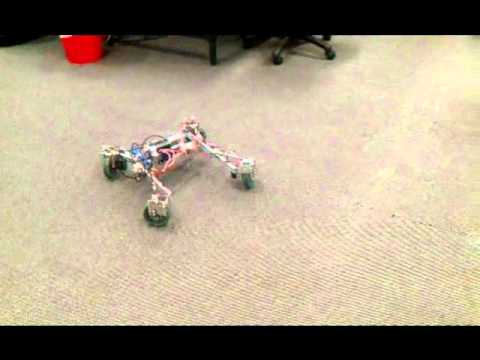

This is incorrect. For an x drive and tank drive with the same wheel size and max rpm, the tank drive is 1.4 times faster. The reason x drives lack pushing power is that their wheels push against each other in the direction opposite to the movement, wasting torque that is applied in the same direction in a tank drive.
While this would seem to be the case at first glance, it is not. Here’s a good video to demonstrate:
And here’s the math behind it:
https://aura.org.nz/why-is-x-drive-faster/

Na i’ta’int. The link in the post above mine has an article about the math behind it. X drive is faster.
