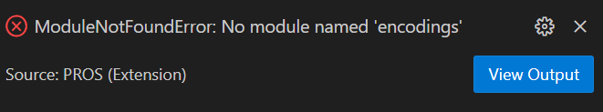

I opened VScode and PROS automatically updated. Now whenever I build my project I get the error "ModuleNotFoundError: No module named encodings. Is there any way to fix the error or install a previous version of PROS without this issue?
Pros Issue
Another error I found in my Output is:
“Fatal Python error: init_fs_encoding: failed to get the Python codec of the filesystem encoding”
Your local version of python is being used instead of the one packaged inside the CLI. We are actively working to resolve this issue. In the meantime, please install our officially supported version of python (3.10.11). Then, restarting your computer should resolve the problem.
I restarted my computer without downloading python, and it solved the issue. Thanks.

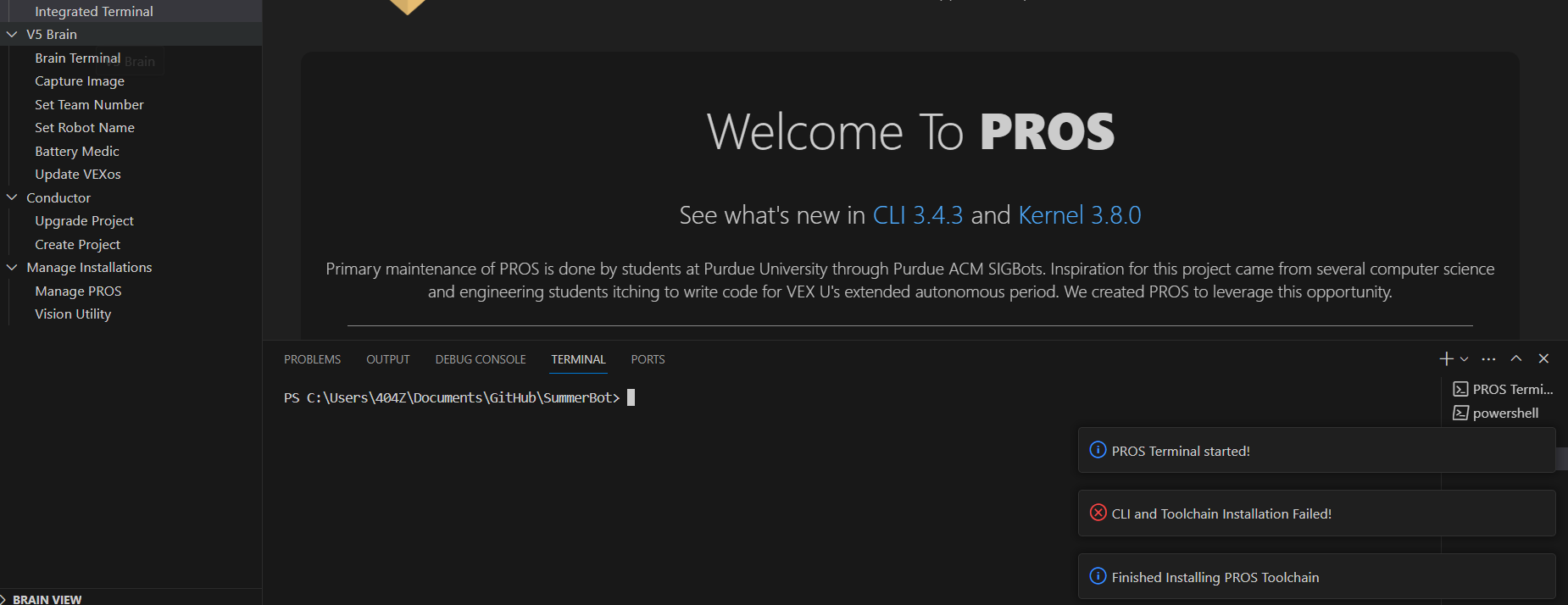

We updated our PROS to v0.7.0 and are getting this error saying that CLI and Toolchain are outdated or not working.
After pressing “Install now!”, this pops up,
saying that our CLI and Toolchain are out of date or just not working. I was hoping you could help us with this problem. thank you so much.
